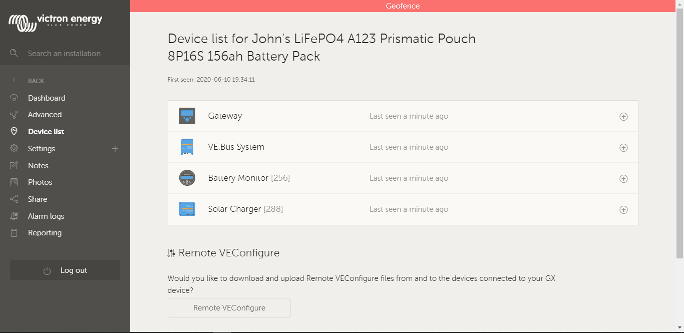

I just upgraded my old PIP4048MS (purchased September 2015) with a Victron Energy MultiPlus II Inverter Charger 48 5000 70-50 IP21.
The SCC in my PIP4048MS smoked itself about a year ago and MppSolar will not supply me with a new SCC as the inverter is too old.
https://www.ebay.com.au/itm/Victron-Ene ... 2749.l2649. I was amazed how compatible the connections are. Also needed a seperate Smart MPPT solar charger. This inverter can export power to the grid or it can just be setup as an off-grid inverter. And this inverter is actually designed for lithium batteries. Weighs a ton (29kg) compared to the old PIP4048MS. Built in India and designed in the Netherlands this inverter feels like quality. And this inverter is CEC approved which means you can get solar panels installed by a CEC Accredited solar installer and the cost of the solar panels will mostly be covered by STCs (government rebate - Australia only).
Below is my CCGX monitor setup in my kitchen.
Below is a picture of my VRM portal. Everything can be viewed or settings can be changed over the internet anywhere in the world where you can get a WIFI connection.
I am posting this for anyone who is looking or considering buying a better designed inverter and is willing to spend more then this is a good replacement.

The victron units are good inverters but the cost difference is enormous if I had used their inverter then purchased all the MPPT chargers needed that are part of the mpp solar units it would have cost me 4 times as much if they brought the price down and made them competitive they would sell a lot more. As a person who could design and build an inverter I do not see the extra cost in them, for a commercial installation I can see them and similar units installed due to warranty etc.
