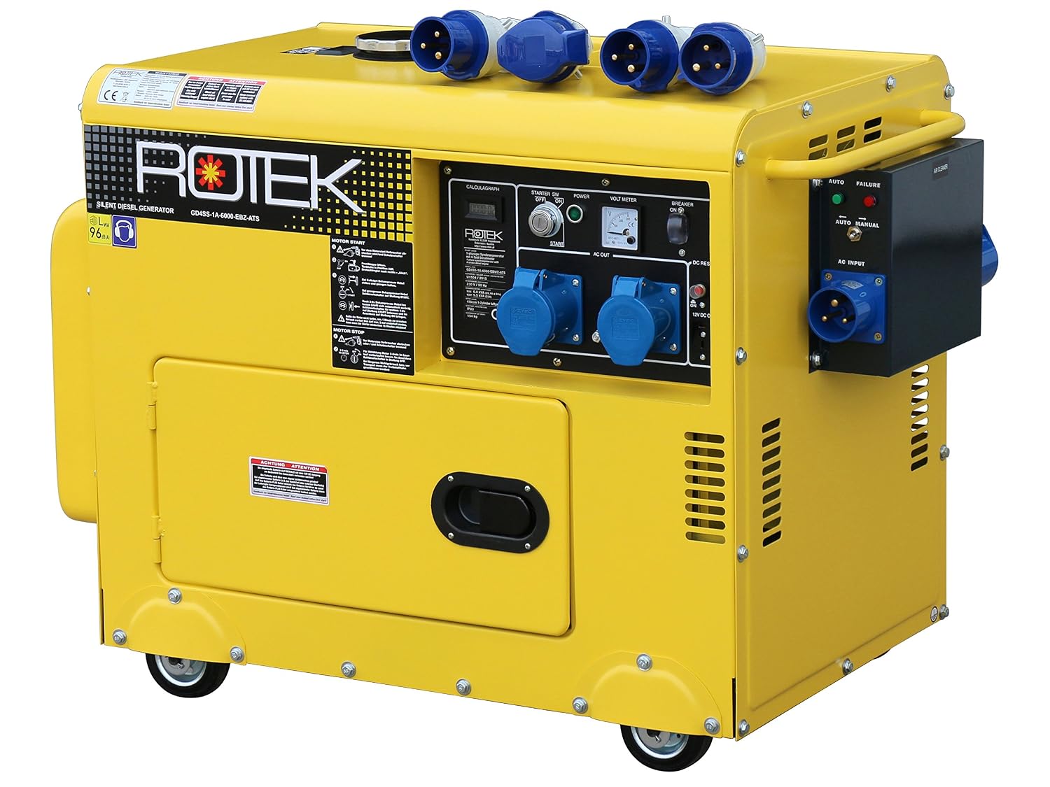

Measuring the voltage I saw that when the charger starts it would spike from 240v to 280v or so, apparently causing the inverter to drop off.
Yikes. 280 V will definitely drop off the inverter.
... where each put the blame on the other,
I don't believe it! Oh wait, the other thing :(
I tweaked the rpm regulation from 52 Hz (no-load) down to 49 Hz and then it started to work. But I could only use 20A charging current, as soon as it reached about 25A the generator would drop below 48Hz and again the charger would drop off, and the whole cycle would restart.
I think you really need a generator with a good electronic regulator. I thought that the larger diesel generators would have this, but spiking to 280 V suggests otherwise.
I tried 3 different ones (air compressor, deepwell pump, suction pump, all between 400-800W and any one works), while the motor runs it seems to smooth the waveform (havent compared with oscilloscope yet) and the inverterstarts to charge just fine.
Interesting. I think others have reported this as well.
I might add that there is 50m of 2.5mm2 cable between the genset and the inverter, I dont susprect thats a problem though.
50 metres? I think that could be a large part of your problem. I'd go for at least 4 mm²; 2.5 mm² is too small for 5 kVA (even though the PIP can't use all of it, charging plus loads conceivably might). Perhaps if you could adjust the generator output to 230 V (without reducing the frequency) it might help also.
Will an upgrade to a newer version help, what do you think? Parameter 3 is already set to Appliance.
I haven't been following the generator saga, but my impression is that no, a firmware update is unlikely to fix the generator issue. However, it's a pretty easy thing to try.
Yes, maybe I should try a different one... This is the one thats built in:
I'm not really worried about voltage sag and the most I'd ever use would be about 3kW. Might the long cable increase harmonics or other irregularities? I could try a shorter one (10m) when the big genset is back from repair...

This is the one [ electronic regulator] thats built in...
I was thinking something much bigger than that. I'm thinking of a 300 x 400 mm PCB and a throttle actuator you'd never win an arm wrestle with. Granted, that was an 18 kW model.
Coulomb wrote:50 metres? I think that could be a large part of your problem. I'd go for at least 4 mm²; 2.5 mm² is too small for 5 kVA
Oh. I was thinking fixed wiring; I don't think you can get thicker than 2.5 mm² in an extension cord.
I think it could affect the stability of the combined system. The generator is attempting to regulate the output voltage, and the inverter is attempting to regulate the battery charge current, and they can interact in strange ways.
I think that would be an excellent thing to try, if it's convenient.

Well, thats whats included in 6KVA china consumer generators... I guess as long as it suits 90% of people, it's good enough for the vendors.
