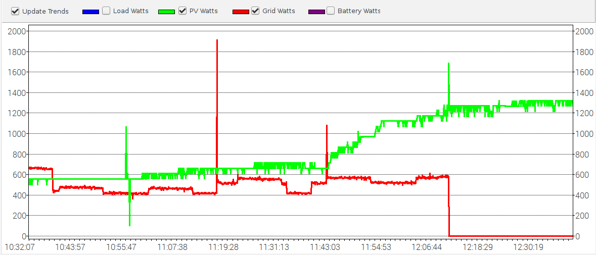

It's the second time I see my inverters reporting a brief surge in PV production the exact moment of the switch from grid to solar. Would this be a freak coincidence, an artifact of the monitoring software (ICC) or just normal physics (that i would like to understand)?
I caught the event from today at 12:10:30 "on camera":
P.S. load was reported constant (not shown on the graph above)

Could it be the panels weren't at max power point until the inverter took some of the load? Likely array output was higher than what the batteries could take?

antiscab wrote: Fri, 22 Jun 2018, 23:28 Could it be the panels weren't at max power point until the inverter took some of the load? Likely array output was higher than what the batteries could take?
Thanks, that could have been an explanation as I haven't provided all the data: the power generated at the moment was well below the maximum charge current * battery voltage and the batteries were not full. Plus that the power level just spiked, shouldn't it have staid up after the inverter took the load?
Anyway, it was just a harmless spike on the graph that made me question my understanding of the system
