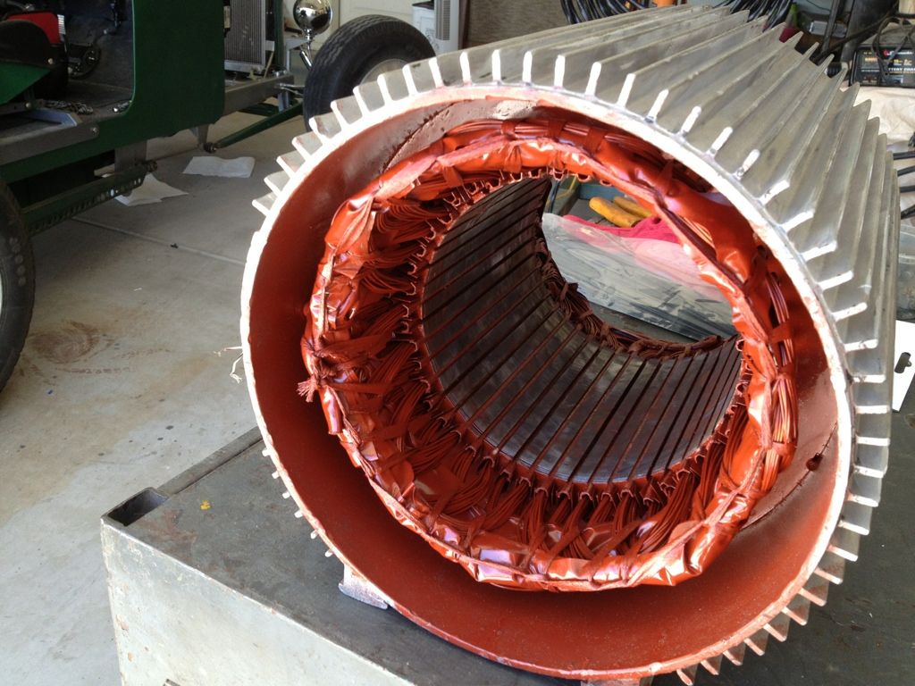

Mouse, your motor should look like this:
It is wound for around 50 volts and has one turn in each pole and lots of parallel wires so it can handle 300 amps cont. and 650 intermittent.
Miz
Miz

mizlplix wrote: Mouse, your motor should look like this:
Miz
You've done a nice job there Miz, looks very clean.
How many "in hand" is this? Bit hard to count lol.
That'd be a great winding if only you could run it at 400V to get the RPM you want/need.
Rgds,
Stiive
Stiive

Miz: That sounds about right. What sort of results did you get with that motor? Seat of your pants is fine
What frame size is that? Your phase windings coming out look even bigger than mine (hence the 300a cont I suppose).
Stiive wrote:That'd be a great winding if only you could run it at 400V to get the RPM you want/need.

That was my very first motor. If I remember right, it was 24 in hand (those motor leads were 48 strands of 18 Ga. and one turn) The motor was based on a 7.5HP core. It ran OK above 1,500 RPM but the bottom end was kinda soft.
This one was based on the 20HP core that we are now using.
It is 12 strands of 18 Ga, 24 strand motor leads, and two turns.
It is a torque monster and runs like a DC motor. It easily spins the tires and has a fairly low current draw at cruise, but only has a 3,100 RPM top speed and would need a transmission to be a good EV motor.
Our fourth wind will be similar to that except it will be 8 in hand and three turns but, we will be skipping slots to change/delay saturation and pick up some RPM.
Miz

Canberra32 wrote: Already had the single phase motor
Ill check out the 3phase tomorrow it's about 280x400mm in size ill get the specifics
280mm diameter sounds like a 132 frame motor. That's the frame size I've got. It's certainly possible. I have a spare 132 aluminium frame motor that I'd like to have a go at re-winding myself. Miz, do you have a record online of your various windings and results? I've had a look through your forum, but I didn't have any luck finding such details.
The spare motor I have is shown in this thread. Can you identify anything about it for me from the pics I've provided?

On 60Hz motors, we have a rule of thumb to use to determine the pole count.
Number of poles RPM
2 3,600
4 1,800
6 1,200
8 900
10 720
12 600
Having said that, what really matters is that it is a 36 slot stator. That is the best one to have because it can be wound to just about anything.
(The following is my opinion from having three EV's and testing to this point, 5 custom wound motors.)
First of all, I would not consider anything but a 4 pole winding for EV usage. It is the best all around for torque and adequate RPM.
It needs to be permanently in what we think of as Delta, because there are no internal motor leads needed as it is a single voltage motor now.
(In a purpose wound, single speed motor, there really is no such thing as delta or wye anymore. It is just how the motor is wound...)
We have also determined by trial and error....that 18 Gauge wire to be optimum for an EV motor. It handles the high current, it is easy to wind with, and it is good for voltages between 30 and 90.
As far as a pattern for winding: Wait a couple of weeks for us to get the next motor wound. We feel it will be the best one yet.
It is a further modification of a basket weave style. It will have 3 turns around each pole but skips 4 slots to pick up some back iron.
We are shooting for good torque over the whole RPM range, low cruise current draw and a top RPM of about 4,500.
My motor is a 48 slot and a pattern of it would not really do you much good, but Ivan's motor is a 36 slot, so He can print the one for his motor.

AC electric motor rewinding for EV use
Ok while I can take a few bits of steel and weld them into almost anything electric motors past the on off function to me operate on what I assume is magic...
Perhaps the question I should have asked is who do I send it to to make it EV ready?
Mechanical engineering no probs but electrical is a fail for me :/
Canberra32 wrote: Perhaps the question I should have asked is who do I send it to to make it EV ready?![]()
We got our SAE motor rewound at Genertech in Victoria - cost a few thousand $ tho.
There should be similar shops all around Australia.
