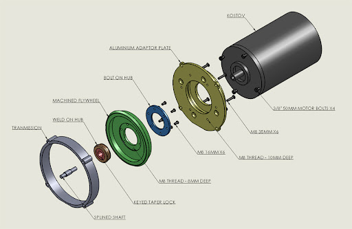

TAPER LOCK
Picked up a 1610 taper lock bush this morning, they're having trouble getting a bolt on hub in the size i wanted, so I'm getting a weld on hub to match this bush, will make it work in some way or another.

Would be nice if we could have that as a front end to a charger...
That Taperlock is 1-1/8" You have a 9" Kostov, aren't they a 1" shaft?

EV2Go wrote: That Taperlock is 1-1/8" You have a 9" Kostov, aren't they a 1" shaft?
Even though I know well it's 1-1/8" I still thought eeep! No, it is 1-1/8" - I had it sitting on the shaft this arvo. Maybe it's a new model thing.

Ok maybe they decided to upsize it to the same size as the Kostov 11"

Getting some stuff together for my first meeting with the engineer this week. This is the current proposal for the motor coupling.
EDIT: Adapter plate is now a 40mm thick machined billet. Not layers.
Generally progress has been slow of late. Hopefully meeting the engineer will get things moving again.
