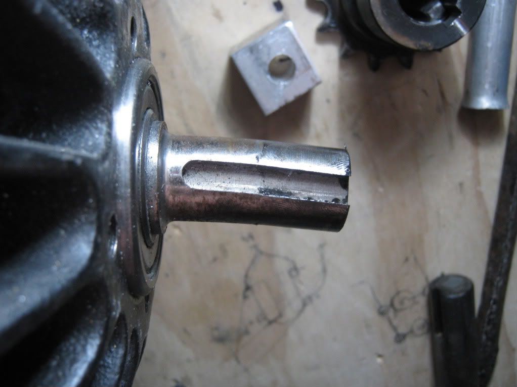

Guess what probably caused your shaft to pull out...

This is what the shaft looks like:

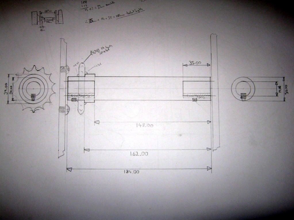

So these are my new plans for a replacement:
As soon as I get a new motor shaft...

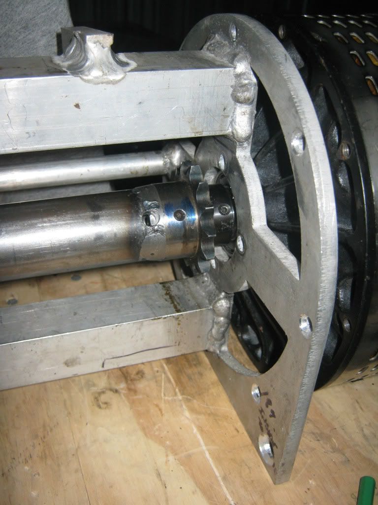

If you are going to use a solid shaft between the two motors, you will need to accurately machine the fabricated motor mount so both motors are absolutely dead in line, both axially & radially.
No matter how good the welder is or how tight the jigs are, ALL metal moves & shrinks when it is welded.
I have seen this many, many times after 20+ years in the metal fabrication/engineering game.
Your only other solution is to use two of any number of flexible type couplings. One at each end between the motors & the center shaft.
The centre shaft must then also be supported in its own set of bearings. These bearings will take all the radial load imposed on the shaft by the drive chain.
The shaft must also be strong enough to resist the bending moment imposes on it. This will depend on the diameter of the shaft, what it is made of, where the drive sprocket is on the shaft & the distance between to bearings.
Most of the flexible type couplings are designed to take axial load only. The challenge there will be to find a coupling that will cope with the torque of an electric motor as well as the maximum rpm.
The Lovejoy type you refer to usually have a cast iron carrier & are severely prm limited.
If it were me I would be machining the motor mounts to ensure motor alignment. I would also be using a solid shaft but final machine the shaft after any welding so that it runs absolutely true & runs in balance.
From the pictures, I don't think your motor mount arrangement is stiff enough. It is aluminium & aluminium is not that stiff or strong. Any radial load on the shaft is going to try & flex the shaft & pull the front of the motors together causing more flex in the shaft pulling the motors in more causing more flex etc etc.
The moutor mount assembly as it is can easily twist & flex. This is a no-no when you are trying to align 2 powerful motors & keep them in alignment when under load.
I reckon you need 1 or 2 chunky struts welded in the front area of your motor mount to stop the front edges coming in.
Weld some more diagonal or triangular braces in too to make it really stiff.
A lot of metal was cut out of the end plates. It would have been better if they were solid.
Then machine the whole lot so the motors are dead in line.
The connecting shaft should be long enough to almost touch the bearings on the motor shafts & the keys & keyways should be full length too.
If you don't do this you will get vibration, shaft fatigue, breakages, etc.
Not very good if the shaft is rotating at a high rpm under a reasonable load & you are lying over the top of it.

Yes, I agree on all points. The solid shaft is the only option I have for this bike, as it is too late to change anything substantially now. Centre bearings would be the only way to improve this setup, but the motor shafts are simply too short and the single load-bearing bush is no good for high load applications.
The plates were laser cut and welded on a precision jig, so they are as close to aligned as I can feasibly get. Despite the shaft failure at ~85 km/h the plates are still as aligned as they were when I first installed them - the steel keyways failed, not the ally.
I can't put any more support to the front as the battery packs actually reside between the two motor plates. I could possibly get more supports welded in the corners towards the back though. And the laser cut plates could be repeated with less metal missing, but again, timing.
I believe that my arrangement will be fine for the 4 or 5 races I will be entering into. Sure, the bearings will suffer from the rubbing at high RPM, but it will probably become a commuter after the season. This bike was always going to be a prototype, and the next bike (wife permitting) won't use Agnis again. Too much trouble.
I have my new 38 mm shaft ready for turning, just have to pop the bent motor shaft out

Great project!!! Regarding the bent motor shaft, I saw in a video about similar motors (LEMCO) that you can put whatever shaft you want in them when ordering so you might be able to replace the shaft instead of get a whole new motor. Pulling the motor apart requires special jigs though so would probably have to send it back to the factory.
http://www.youtube.com/watch?v=xbVTqkE_F1U
Good luck!
Andrew

Way ahead of you mate

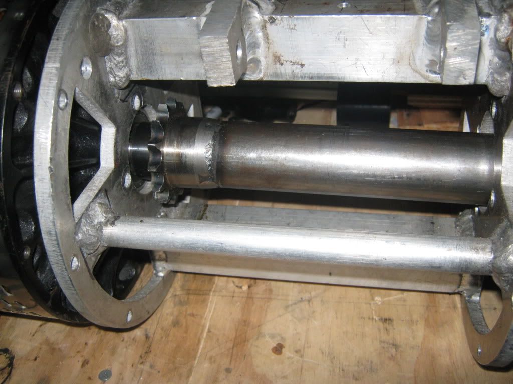

Agni Motors kindly sent me three replacement shafts and it was a half-hour job to get the bent one out and the straight one in. The special jig was easy to make myself.

Curious about the weld... how did you keep the cog true to the shaft centre line while it was welded?
- jonescg
- Senior Member
- Posts: 3726
- Real Name: Chris Jones
- Location: Perth, WA.
Voltron, the Electric RG!
It was stepped on the lathe first, so that it fit snugly in place, Then the V was welded and finally smoothed off on the lathe again. Not me, though. I can't build anything to save my life!

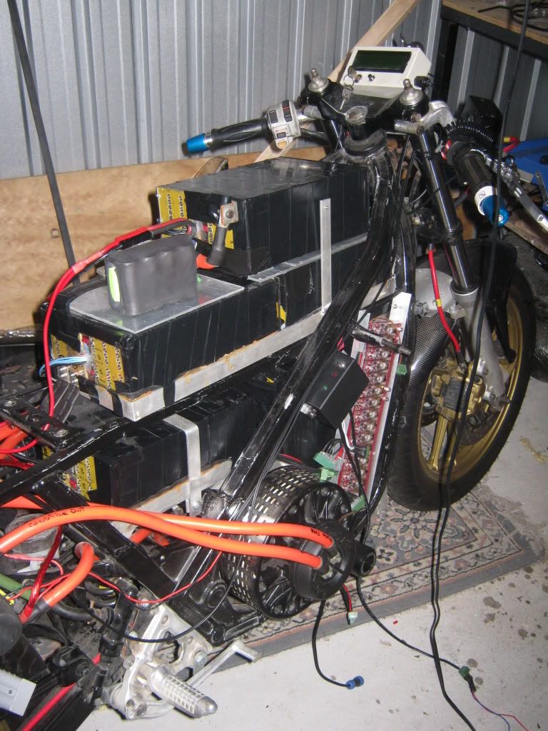

Took the day off to finish re-re-reassembling the lecky bike. Started with the 12 V fuse box. Since my axillary battery uses the same lithium chemistry it can pump out a hundred amps no trouble, a few fuses are a good idea.
Got the motors shimmed and the shaft turns freely
So I set them in the bike, and started the long process of mounting al lthe batteries and terminating them. Only got shocked once this time!

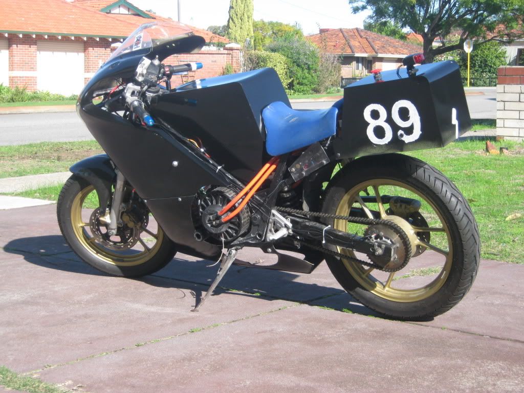

OK everybody, Voltron is finally ready in it's latest and hopefully most complete state. Yesterday I got home early so I could put the chain on and go for a quick 'diagnostic fang'
And the motor bolts foul the chain
So in what must be the eleventh time, I fully disassembled the bike, pulled the motors out, split them, removed the offending buttonhead bolts and put them all together again. I had to re-shim the spacers as I lost track of which one was which. The bike was fully reassembled from parts in 4.5 hours. Quite proud of myself actually
Here's me looking a bit weary last night:
So today was a matter of testing the bike (of course) putting the fairings on and getting a few proud photos, before crating her up.
It rides quite nicely and the new stiffer suspension worked a treat! The new 14 mm master cylinder delivers much better stopping power - not bad considering the pissy little 27 mm callipers are at their limit. I only cracked 92 km\h on my breif spin around the block, but it's fair to say I did get there rather quickly. Vmin x Imax = 70 kW
What's that I hear you say? The tank must be uncomfortable? Yes, it is. But I can't fibreglass to save my life and no bastard would take my money to do it. So maybe I can find a willing soul over east who can do it.
Once crated, I rode the 'Bird up to Bunnings and borrowed a ute. I called on 5 other mates from UWA to turn up and help me hoist it up onto the ute. Not bad work for a case of Coopers. Watson's Transport are taking her to Sydney and delivering to the racetrack probably Thursday evening, and for a good price too
Phew, I am stuffed. Think I need a beer
