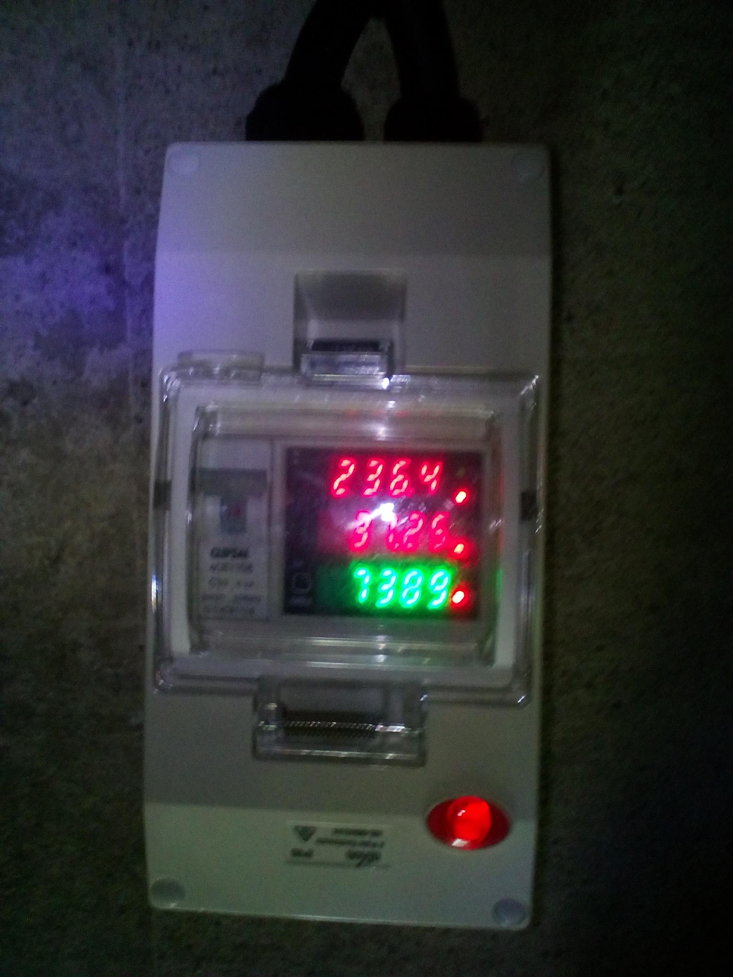

Note that the last pic of the HPWC shows that part no. Ends in 02-J
Supposedly 02/03-x units are locked into Tesla’s even with legacy mode enabled.
Interesting how holding the type 1 microswitch down for 3 secs seems to work.

EVdownUnder wrote: ↑Sat, 06 Jun 2020, 17:53 One of the country Victoria motel I visit have their charger set to Tesla only and are willing to let me open it and change the switches, but I would not attempt it without knowing which position the 2 micro-switches need to be set at.
The photo shows dip-switch 2 in the up position. The installation video tells you to leave dip-switch 2 in the up position.
Set the dip-switch 2 in the down position (off position) and it starts charging right away.
Short cut for Tesla Charger install video:https://www.tesla.com/support/installat ... edirect=no

Re: Charging your non-Tesla EV from a Tesla charger
TPN ends in 81-J
Maddington Toyota
1910/1914 Albany Hwy Maddington
http://api.plugshare.com/view/location/271270
Maddington Toyota
