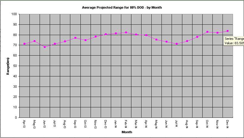

Interesting article. Also noted in the article that even Tesla isn't immune.
I log every charge with AH used and distance travelled to calculate range at 80% DOD in my 12kWh DIY EV. Graphed here. It's pretty easy to see the coldest and warmest months. Melbourne temp range is around 5 (July) to 30 (Jan/Feb) degrees C.
The data pre Oct 2013 is a bit erratic as I settled into a driving style.
The graph pretty indicative of what I have read about the range vs temp. for most EVs.
Sorry if I've posted this before.
