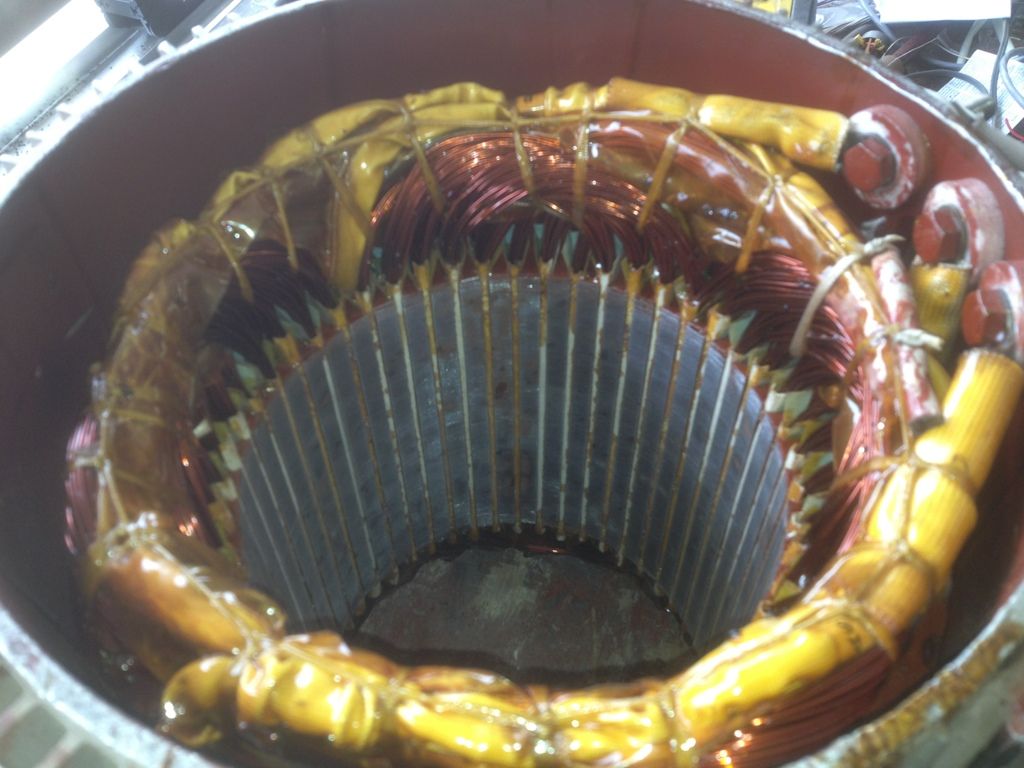

Winding your own motor is not that hard, but it is mysterious until you have that last puzzle piece fall into place. Then you are amazed at how easy it was and why you didn't see it in the first place....
OK, A 3 phase motor has 3 separate phase loops of wire. (loop, circuit, coil, whatever)
Each phase loop has it's own start and finish (wire ends).
3 phases X 2 wire ends each = 6 wire ends (3 starts and 3 finishes)
We combine each start end with a finish end of the next adjacent phase giving us 3 larger bundles of wire.
which we pull up out of the case and call our three motor leads, "W"-"X"- & "Y". (are you with me so far?)
That emulates a Delta winding pattern.
Each phase starts at a point and goes around the whole stator and ends near where it started.
The second phase is wound on top of the first.(except moved over some slots)
The third phase is moved over some more and placed on top last two. (3 layers of windings)
These 3 layers (Phases) plus the top insulating stick, should fill the slot fully.
Other than the pattern of slots where you lay the wire, that is about it.
I am trying to get Ivan to do a video of winding a phase and use a piece of wood cut to emulate a stator out flat to make it clearer.
Motor insulation comes in different heat ratings. Get the best you can.....
Motor supplies (in the states) cost about $400. That and 8 hours of hand work will save you a lot of money.
And the satisfaction you get every time you drive the car, knowing you built the motor.
Miz

I spent the day taking my stator to
Ivan's Garage in Tucson to get it rewound
for try number four.....
(as you remember,even though it performed
well in traffic, #3 tended to run a little
warm at 107C and pulled too much current-115 amps @ 40 MPH.)
It is documented here:
Ivans Garage Forums
And a good time was had by all, (except me,
I was kinda tired)
I will post as soon as I get it back.
Miz

Hi, Everyone:
Sometimes progress is slow and other times progress is even slower...
We finally got our motor rewound for the fifth time. Every time used a different variation of our first winding pattern. Every one ran but had some type of performance issue.
The first one was the best all-around. It used 12 in hand, two turns around. It had killer torque up until 1200 RPM and good current draw at cruise. But it only had a 3,100 RPM top speed.
(The wire gauge made almost no measurable difference.)We used 18 Ga. as the largest yet easiest to work with.
At this time, the motor is at Ivan's shop being rewound to that. It will get dipped and baked before he calls me back for pick up.
To make this motor work, I will then change out the differential gears from 6:14 to 5.13 ratio. That will give me a 58 MPH top speed. (93 KPH)   Which will work fine as I never go above 50 MPH (80 kph)in town.
I found out that in a standard industrial motor, trying to push it above it's design RPM, makes the saturation problem much, much worse.
SO it is important to get your priorities right....Low cruise current draw (first), ability to absorb high amps for a decent duration (second) and decent torque over most of the RPM range (Third).
If you want a high top RPM too, you must give up one of the others.
I selected to gear the car to suit the motor and keep the first three.
I will get the new stator back by wednesday probably.
Miz

I have returned from Tucson with the newest motor type.
It is nicely wound, dipped and baked.
It is 12 wires in-hand and two turns. 18 Ga.
We decided to do the motor cables this way instead of the HPEV way of bringing them out of the case for termination. Both ways has their good and bad points.
Our way, you need to be careful not to rotate the studs and ground out the inside leads against the case.
The insulators are lathe turned and good for 500C.
I will be putting it back in the car this morning.
Miz

Lol....that was the last try...it did pick up top RPMs, but there was no torque up there. That beast would run 6,100 RPMs no load.
It would only do 3,500 RPMs or so under load. That was a bust.
We then tried to change the phase spacing , but the controller went nuts.
After the unit comes out of the oven everything is charred black and powdery. After you yank out the copper, it needs wire wheeled and coated with the red spray varnish.
After winding, it gets soaked in motor varnish and baked(350f for 2.5hrs)
Then the stator flats get gently wire wheeled clean. The gap is .010" or less. There is no real work given to the individual stator lamination plates or between them. They seem to do just fine.
The shops doing regular rebuilds do not address this issue either.
We are back to our favorite motor. 12 in hand, 2turns, 18 ga mag wire.

by mizlplix
Plan: I just took time out and read your entire thread.
It sounds like a really good project to simply rewind the stator to a lower voltage level and run a controller of your choice.
Which controller do you want to run?
What is the RMS voltage range of the controller?
My motor is a 48 slot stator also and it was easy to work with.
If you simply take it to a regular motor shop, they will normally not be able to change it over, as they are used to just "Remove and replace" type of repairs.
They can (and will) not alter the windings as they do not have the knowledge to do the engineering involved and will tell you it is impossible to do. (We know as we tried early on)
If you can tell me your requirements, I can tell you how to wind it.
Voltage- (RMS, not pack)
Pole count wanted    (I have found that 4 pole is best for lower voltage systems as it picks up torque (but loses some top RPM).
I was able to re-gear to suit, where you are fixed at what you have.
Miz
AC electric motor rewinding for EV use
Posted: Tue, 23 Jul 2013, 05:08
by mizlplix
My new motor is installed and I am currently running it and doing controller optimizations to it.
So far, it seems to be really good for my needs.
I drive in town, so 50 MPH only is needed. I am getting a 56 MPH top speed. (direct drive car, no transmission)
The acceleration is not "racecar" swift, but it IS just faster than the traffic around me.
My Cruise current is around 80-90 amps @45 MPH.
(1,900 LB car, flat terrain and no wind)
I am still fine tuning the field weakening values to even out the torque band some.
I get in 2 hours per day driving time. This is the fun part for me.
More later. Miz
