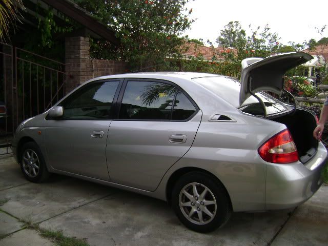

Here's the damage Image
Seems to have been a small fire with the upholstery around the HV battery box that mustn't have lasted too long, as the damage is localised to that corner.
This is what it was like when I got it. Someone had already started to remove the battery, but stopped for some reason (Maybe the insurance co had toyota look at it to determine a repair cost???)
I've removed the back seats and other junk from the trunk. Now I need to remove the battery and find someone to fix it, or attempt it myself. I decided not to remove the battery on the weekend, since I don't have any HV insulation gloves - anyone know where I could find some in Perth?
