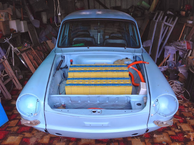

Some pics of the front battery pack going in:
