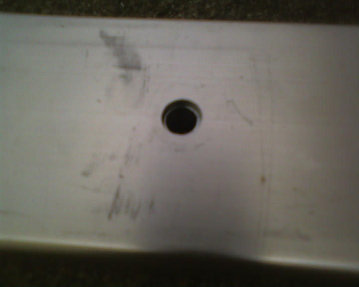

PaulWay wrote:I'd watch out with using clamps to hold the torque arm to the swing arm. With the amount of torque the motor can generate, I'd imagine it will be able to start slamming that arm against those bolts only a couple of runs after you've fitted it. Would it be a better idea to bolt the torque arm directly to the swing arm by a hole (or holes) drilled through both?Paul
Well at first I thought drilling holes in the swing arm was a bad idea but when the enginee also said it as an idea and explaned that the stress is along the edges (not in the middle) I have changed my mind.
heres some pics
Started with this to put inside the swing arm so it would not get crushed when I did up the bolts.
Then when I tried to put it in I realised this.
The dimples at the bends !
So then I made these other 2 (1/2 the hight of the original) so I could put one side in first, and while holding it in place, put the other 1/2 in.
Here is the finished results (both arms of the swing arm done)
Getting the 2 halves in place was a bit of mucking around but not to bad.
I have settled on SE100AHA (Sky Energy/CALB) as they are a little bit lighter and smaller and deliver better power under load. But before I place my order for them (via EV Works) I am trying to sort out BMS and charger - I want the 2 to talk to each other so I need to buy them as a set.
I am keen to order the batteries as there is a 6-8 week lead time on them.
Last weekend I got a back brake hose made up and bought a hydrolic cluch leaver assembly for left hand operated rear brakes. I also made a brass fitting for a pressure sensor (on order) to work the regen braking. When I apply small pressure to the rear brake lever the regen starts to work and increases with more pressure. 0-5V input to the controller from the pressure senser. Also a second pressure sensor for the brake lights (its built into the banjo bolt that attaches the brake line to the brass fitting). I include pics when its all set up.

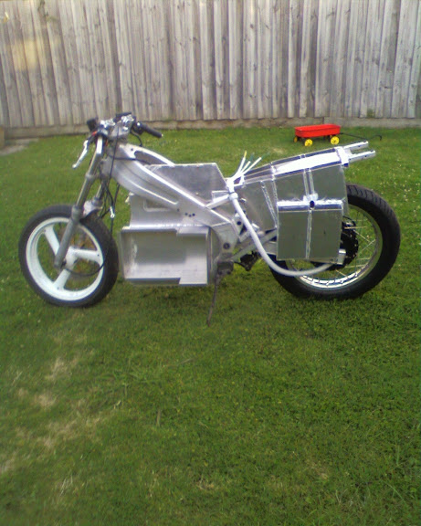

Well finally I have got the front battery box welded up and in the frame (only 5 1/2 hrs. of welding!). Thats 26 batteries done, 10 to go. Here are some pics.
The back frame will be cut off and a battery box added in its place. The frame is cut on the top rails (so I could weld the front box in) but not on the bottom ones so I still can see and measure where things go.
A view from the back
From the top looking inside
clearance when at full suspension compression
Obviously over the past months I have been measureing and cutting aluminium plate in various shapes to make this box. It was way too hard to try and explain which bit went where and why. Much easier to build it and show the result.
Over all the welding went realy well. Some warpage when welding the side boxes to the main one but this can be fixed by cutting and rewelding some welds. I guess I will know just how well it went when I get my batteries and try fitting them in. Its been 4 months and still waiting. Hopefully here in the next couple of weeks.
Regards

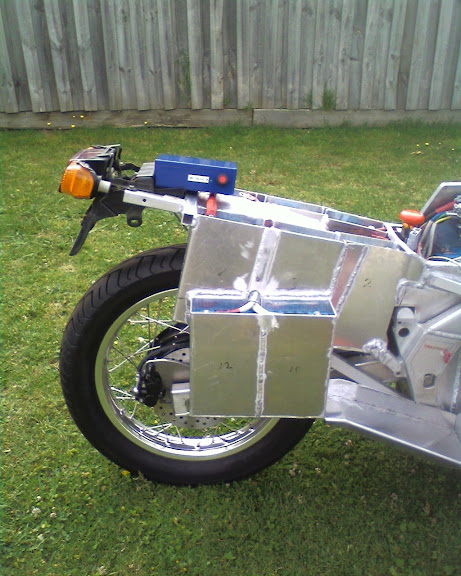

its been a while since my last post (been busy with family matters) but I have still managed to get some work done. Its been head down and bum up for the last month.
Being dissapointed with the welding done by the tradies, I purchased a TIG welder and have been welding anything I think I can to try and master it. The ability to weld things myself have realy spead things up.
here are a couple of pics of where I am up to. 10 batteries housed in the back battery box configuration (or will be soon).
and looking from the top (its a bit distorted but you get the idea)
The small "boxes" in between the last 2 top battery places (on each side) is for cables to go down to the lower "panier" side boxes
when I sit on the bike, with my legs tucked in, the outside of my legs are still wider than the side panier boxes so once the fiberglas fairings are on it (hopfully) should look quite sleek.
I still have some welding to do - the runners for my feet on each side and there will be some lugs to be welded for the side fairing mounts. I take the motor out for the welding so there can be no mistakes - don't want to blow it up.
The front fairing frame will be bolted on to the bike, there are mounts there already, but the frame can be made on the bench.
In case you are wondering how I can blow up the motor when welding - this is what I discovered:-
when pushing the bike a while back I found it was realy hard to push, this pussled me as it has always been easy to push. What I discovered was that the 3 main wires to/from the motor were all touching the aluminium battery box (making a curcuit) and I had re-gen braking !
If this happend while welding I could end up with a blow motor or, at least, the position sensors. Best to paly safe.

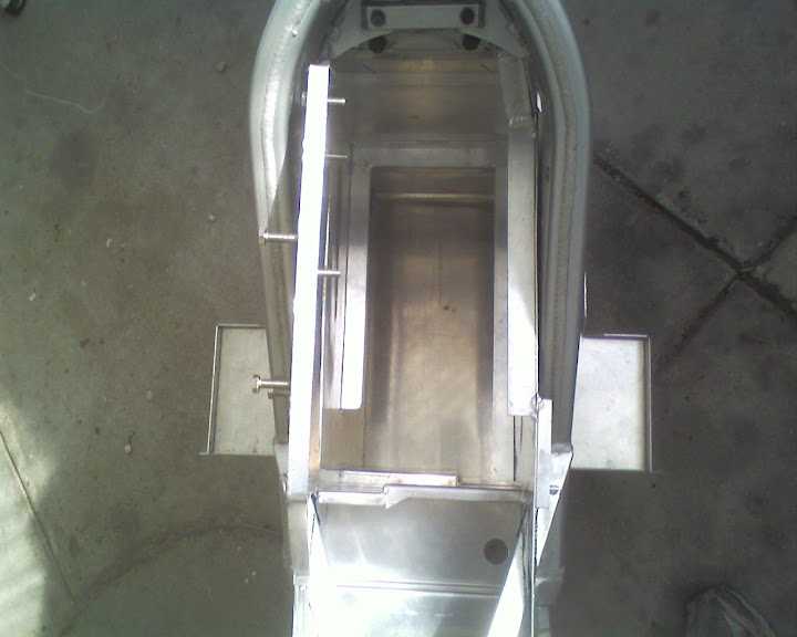

some more pics
This one shows the running boards (no foot pegs)

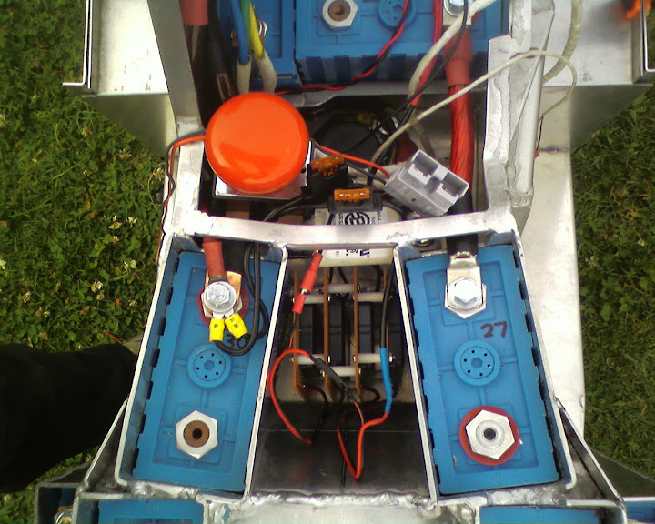

notice also the controller,big red emergency stop button (will be in storage compartment) and rear brake light (blinkers are to close togeather so I will need to add stand alone ones for ADR compliance (12 iches from center to center).
Here's a peek inside (the now very busy) "electrical" compartment - Big red button,fuse,contactor and DC - DC converter (in between the 2 batteries) its made up from 4 20W 36-75 V to 12V converer (more on it latter)
here it is with the old seat and petrol tank. I'm going to make a fiberglass compartment from the tank.
Because of the weight of the batteries I am forced to make it a single seater, so the BMS control unit will go here.
Here is where the charger will go. It will be removable so I can choose to carry it or take it out for more "luggage" room
Now to the DC-DC converter (for the very observant) I have cleaned up the wirering from the earlier shot. I have 2 wires into 1 hole and then 2 of these into 1 hole again giving 4 wires into one (the centre 2 holes are +ve and -ve 12.5 volts at 6.67 amps)
As I said earier - its made up from 4 of these modules that take 36 to 75 volts input and give 12 volts output. The output voltage is variable via external transistors up to 10%. Mine is at 12.5 volts. I have 2 one ohm restors (to make 0.5 ohm) on the output positive wire of each module (as advised by an electrical engineer) so they will not "drop out". Two modules run in parallel from 1/2 of the battery pack and the other two from the remaining 1/2 (battery pack is 118.5 volts). And the output is all parallel to 12 volts. They cost about $12 each from US plus postage (which wasn't much). so for about $50 - $60 I have a dc - dc converter with 6.67 amps output. Contactor need 0.67 amp to hold and HID light (once warm) needs about 3 amps. The controller and LED blinkers don't need much (no ADRs to comply with in this area). The only other thing to drive is the horn (havn't tried that yet).
The other advantage is its small and light and I did away with the 12 volt lead acid battery as well, saving more weight. Its always on so it will draw about 0.01 (X 4 modules = 0.04) amps per hour (about 1 amp a day) when idle, so with 100 amp batteries at 80% DOD, thats 80 days between charges when not used. If I were to go on a 3 month hoilday (like long service leave) I can just remove the fuses to disconnect it.
The input to the second pair of modules is the return for the first pair (goes to middle of batter pack) - needs 3 wires all togeather.

turns out - at full throttle the tire grows taller and rubs (and smokes) on the cross member of the swing arm. simple fix - move wheel back a bit.
check out the clearance from this pic
it grows that much - about 8 mm.
