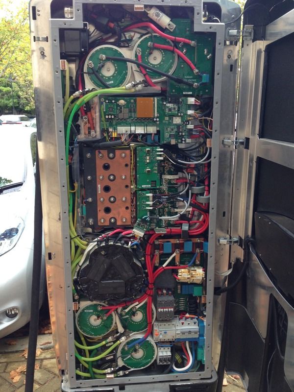

Most fast chargers take 3 phase + neutral, pass it through an isolating transformer, and then rectify this into DC. The DC then supplies the bus of the switched power supply. Since they have an upper voltage output of 500 V, an approximately 550 V bus is needed.
Could you not have a large battery of say, 50-60 kWh, and 550 V nominal voltage, across the DC output of the full wave rectifier? This battery is also constantly hooked up to a ~7 kW charger which maintains the nominal 3.3 V.
A few isolating contactors in the system wouldn't go astray, but it seems like it could work? The fast charger would still need some AC input to run the electronics, although this is no doubt a 12 V supply at some point.

I know it has been done, and there are companies who will do it (including ELMOFO), but I guess my question is - is it as simple as hooking up 600 V battery to the DC bus of the charger? Does the charger need any specific software changes to deal with the new power supply.
After all, battery chargers are really just switched power supplies with a variable voltage output.
Oh and does your ELMOFO charger support ChaDeMo and SAE Combo-1? If it does, you should put in a tender

I think a direct DC bus is possible on most if not all DCFC's. The operating firmware(s) would need to be modified to suit of course. Tritium says it's fairly easy on the Veefil. Cir control Trio's shouldn't be much different...

Yes Circontrol told me it would be possible, but not as simple as it sounds. I assume it's because it needs to sense the supply voltages... but they seemed perplexed as to why you would do it. "Don't you have power in WA?"
