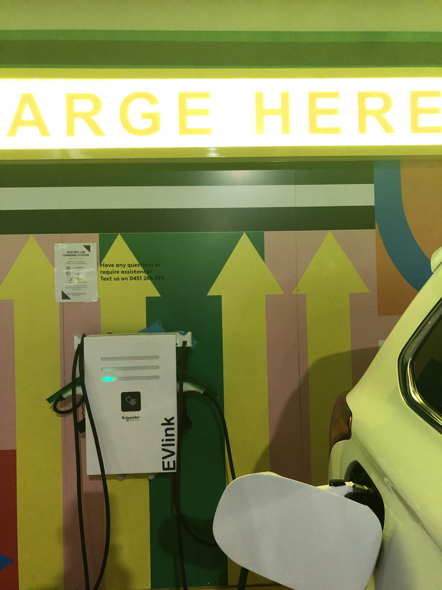

You guys talk about proximity switches or buttons and soft stops but unfortunately this problem is on my Swift conversion. No buttons etc here!
98% of my charging is done at home. To put it in highly technical terms (highly technical for me anyway!) extension lead is plugged into timer which is plugged into power point. RCD and circuit breaker thingy is plugged into extension lead. Charger is plugged into RCD thingy (told you it is technical). This is when I have the occasional problem with blackouts. The blackouts may only last 10 seconds but sometimes longer.
To answer Christopher's question I am using a KPES 2000 charger. Well, actually, I have two of them - one in the boot and one under the bonnet.
The one in the boot:
The square can just to the right of the charger in the picture is a highly technologically advanced water cooling system I invented (patent pending). When I first installed these chargers I noticed they don't get hot uniformly over their surface. While the charger is charging, the right hand side gets much hotter than the left hand side or the top surface. I filled the can 80% full of water and placed a thermometer with a probe in it to ensure I would measure the temperature of the water not the can. On the day of the test, the air temperature was 16C and the temp of the water was 13C. The charger then spent two hours charging. When it finished charging, the temp of the water had gone from 13C to 28C.
When I am charging at a public station I use both chargers through a double adapter. One double adapter for J1772 stations and one double adapter for Tesla Destination chargers or Type 2 chargers. I assume Type 2 adapters won't work in CCS2 charging stations?
Tesla Destination double adapter:
Destination charger.jpg (1.27 MiB) Viewed 467 times
Looks like I will just have to keep my fingers crossed when charging at full pace. I believe that when the charger is in Constant Voltage stage and amps are decreasing, then the risk of damaging the charger is significantly decreased when the power is turned off.

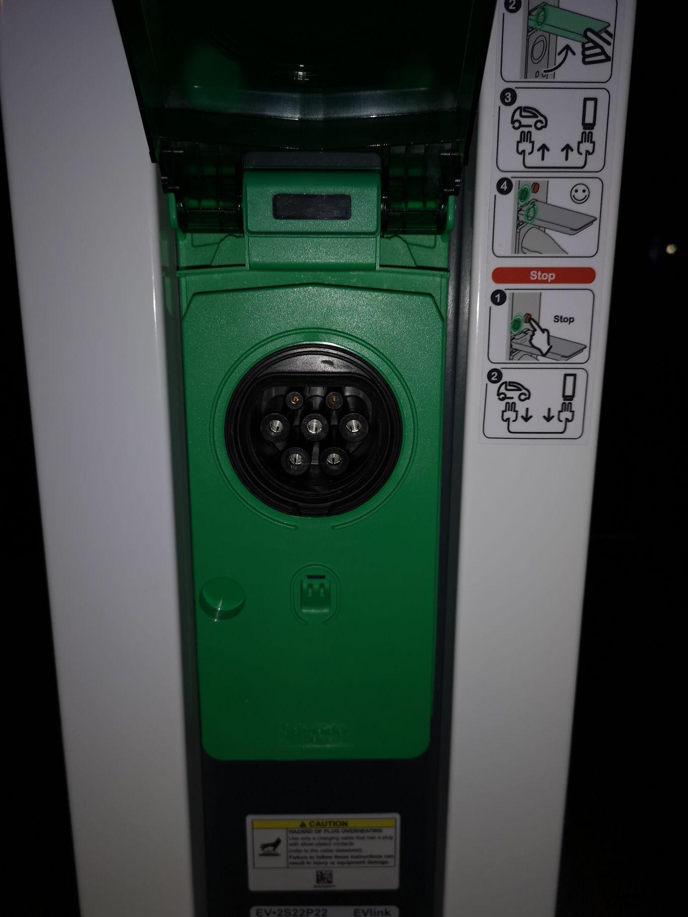

So the other pins are live when plugged in?!

jonescg wrote: Mon, 26 Oct 2020, 10:16 So the other pins are live when plugged in?!
? Those would be sockets, as in any extension cord. Sockets are designed to be safe when live.

Paul9 wrote: Mon, 26 Oct 2020, 09:50 I assume Type 2 adapters won't work in CCS2 charging stations?
Yes. Only the control pins of the AC part are used. They probably don't even have holes for the phase pins, so you couldn't even plug in an AC type 2 plug.

Post by jonescg »
Oh good - couldn't tell from the picture

shallowal wrote: Tue, 27 Oct 2020, 11:45 I have visited a lot of chargers in the NSW/ACT region since I bought the car last year, and have never come across an untethered charger. Admittedly the vast majority of chargers are Tesla ones, but chargepoint and others all seem to be tethered.
Some of them have a cable provided, but the cable isn't fixed to the charger (what I mean by tethered). So the cable can be removed; this is good, because I need to remove the cable for my type 1 Leaf. (I don't want to butcher my type 2 socket, by sawing off 11 mm of plastic.) For example this one at Toombul shopping centre, Brisbane:
[ Edit: I'm pretty sure that all the AC chargers on the Queensland Electric Super Highway are non-tethered. Example: Gold Coast Air Port below. ]
It seems to me that the only difference between type 1 and 2 chargers is the shape of the plug and that Type 2 supports 3 phase. As I mentioned before, I wonder whether the problem with the newer Tesla AC chargers not supporting non-Tesla's is that those other vehicles are not supporting the P1901 protocol.
By P1901, do you mean the ethernet over power lines protocol, per this Wikipedia article? That doesn't seem to be relevant to this discussion.
