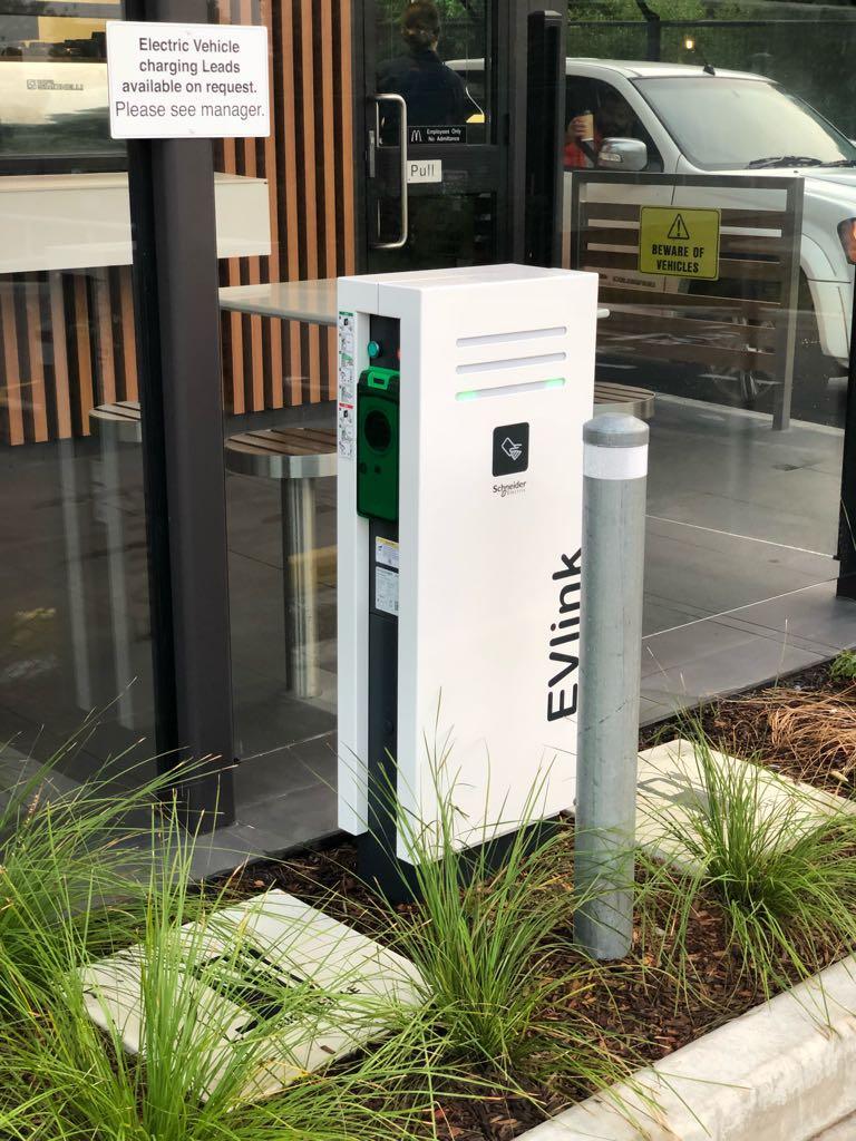

Re: Tesla HPWC adaptor >J1772
I have no idea where you are located. But you can check your cable with an untethered non-Tesla charger (Chargefox - EVlink) at Mc Donalds at Kellyville to check the non-legacy setting theory...https://www.plugshare.com/location/110533 This charger requires you to use your own cable and it has a Mennekes outlet for you to plug your cable into. If your cable works there then your cable is good. But they do keep a cable inside the store. It would be worth checking. You may need to download the Chargefox app onto your phone to use it.
