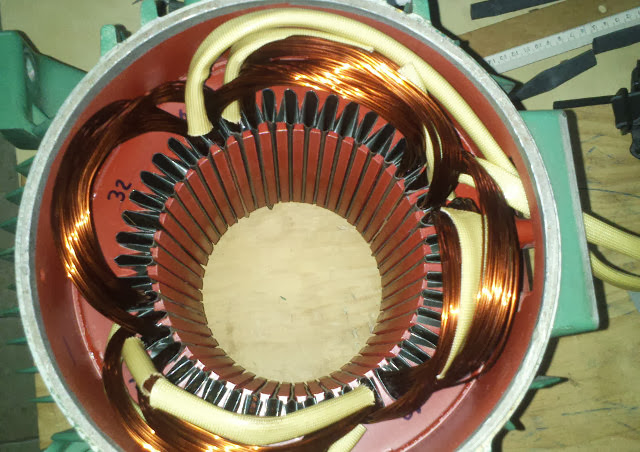

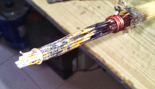

Rewinding update,
yesterday we finished winding the coils. Basically, we followed Ivan's method (with a different layout) as all our experiments proved unproductive.
I have a few tips to share for anybody trying to do the same:
- Good lighting. The stator interior is shadowed easily, and you will be performing precision work there.
- A helping hand. Getting help makes the work only a bit faster, but makes it less tedious and tiring.
- Reduce the number of wires. If the original number of wires in one slot is X, I would recommend going for 4/5 or 5/6 of X. It's too hard for a beginner to pack so much copper as professionals do.
- Get a good material for the wedges. We used the same insulating paper used as base in the slots. The shop assistant told us we could use it for wedges also, in order to save money. Well, it's true. It can be used, but it's just too much work in an already difficult task! And it does not look too strong.
And a recommendation: in retrospective, I should have rewound an small motor first, just to get proficient at it (an waste less copper with my experiments). A motor that was in working order, and big enough to fit the hand, maybe a 2KW one. Working they way I did, I was getting the "art" of it at the end of the winding, and that means the motor looks unprofessional…and if it does not work I will not be sure if it was my fault or the rotor is really damaged…
Ok, first the layout we did. We abandoned the concentric one (the motor original one) for another easier to wind:
I think (but I am not sure) Ivan is using double layer designs only, while this is a simple, single layer one.
Originally, the motor had 56 wires in a slot. 14 turns, 4 wires in hand. We rewound at 2 turns, 23 wires in hand (I reduced from 28 to 23 to make the process easier).
First step, calculate the length of the wire for one phase (ex. X-U) and cut 23 wires. I made a roll with it and let it behind me.
You just keep taking cable from the roll, make a lasso with 1-2 feet and pass it through the stator (check Ivan videos). Then try to fit the wires in the slots.
In order to fit them easily, I flatten the wires as much as possible. Any twist of the wire must be removed; combing the wires a bit can help to fit the center, as they tend to comb out of the slot:
Some kind of "ruler" is necessary to push the wires inside the slot, specially when the slot is packed. I used a piece of painted metal I had, but plastic or wood is probably better to avoid damaging the wire. It's important to use one with the correct thickness, not too thin (or wires will exit the slot).
User avatar
peskanov
Groupie
Posts: 153
Joined: Sat, 15 Oct 2011, 00:55
Junkyard motors parade
Post by peskanov » Tue, 27 Aug 2013, 19:26
Here we have the fist phase built:
The insulated parts are the "bridges" that can be seen on the diagram. All the wire is in one piece, not cuts/connections.
I think each phase takes abut 6-8 hours (not for a pro, of course Image).
Making a good coil head is an art, and I am still getting good at it. I would recommend checking as many videos as possible before shaping one.
A view of the second phase / start of the third:
At this point space starts to look scarce. Wiring is more difficult.
Finished:
It looks so packed, the rotor could not enter the stator! Image
Hopefully, when we apply the last step everything will be ok. Working with so many parallel wire is nasty, as you need too much space to jump from to coil to coil or exit the stator.
New week, tweak the coil heads, solder terminals, check for shorts and varnish!

Update time,
we are reaching the finish line, and at this point I don't even care if it works or not! I just want to see the damned thing done! Image
Some pics of the coild heads packing. Here we are using the nylon thread.
Here you can see (using some effort) the small wire we use to guide the thread trough the coils
The head coils get much thinner when you pack them well, drawing strongly from the thread. But take care or you will get some blisters (or worse)
When we ended one side of the stator, we got a nasty surprise. This Leroy-Somer is short and light (compared to other motor of this size) but the price to pay is less space for the coil heads.
Look at the end plates:
Nearly flat! And we did not noticed it while molding the coil heads. Fortunately, some rubber mallet fixed the problem, but the heads are now too close to the plates and that makes me unhappy. Some nasty induction could be produced there.
Packing result:

After packing the coils, we tested the circuits for shorts, bad insulation, etc...Everything was OK but you cannot test if each phase has the same resistance, as winding for low V/Hz makes resistance so small a normal multimeter will not be able to read it correctly.
Now, the varnishing. That's easier, but also messy.
We wanted to use the method of closing the motor and filling it with varnish. However we just bought 2 litres and that was not enough, so we just varnished it in the classical way.
Fist we filled the slots, as these are the parts that really need the varnish (to get rigid).
That took time, a lot of varnish can be pumped in these slots.
Next we painted/filled the coil heads using a brush.
...and it's still drying, as we did use the cheap varnish that dries at ambient temperature.
Next, the motor terminals. We used a gas torch and sulphuric acid ("Mr Rambo" Image ) to clean the enamel. As we are still working on it, that tale is reserved for the next chapter.

that is some nice looking work / art there mate

Hi Adverse effects,
in the pictures looks much nicer than it is, we are learning an it shows when you a get close view. Thanks anyway!
Well, I am happy to say the motor is alive! Today we solved the terminals problem and tested it without load.
About the terminals, this task is a bit harder than it looks. We used a torch to burn the enamel an then submerged the wires into the acid.
Sulphuric acid is a nasty stuff, it perforated a plastic bottle, made a nice hole in Vicent's t-shirt, and burned my hand a bit through the rubber gloves.
Imho, the acid is unnecessary. If you torch the wires well, the carbonised remains of the enamel can be removed easily using steel wool.
Once you clean the wires (the best you can or tin will not work) you need to heat them enough to solder. That proved difficult, we tried the gas torch, a soldering iron and an hot air soldering system.
All them worked badly, but we found that a hot air gun we have around was ok for this task.

I recommend a concentrated zinc chloride solution, also called Baker's soldering fluid, tinner's fluid or killed spirits. It will remove the copper oxides produced in burning off the enamel, without removing your skin and clothes. You wouldn't have to work so hard with the steel wool -- just remove the burnt enamel, then dip it in this stuff before soldering. Then wash it in water (after it has cooled) to remove this flux.
