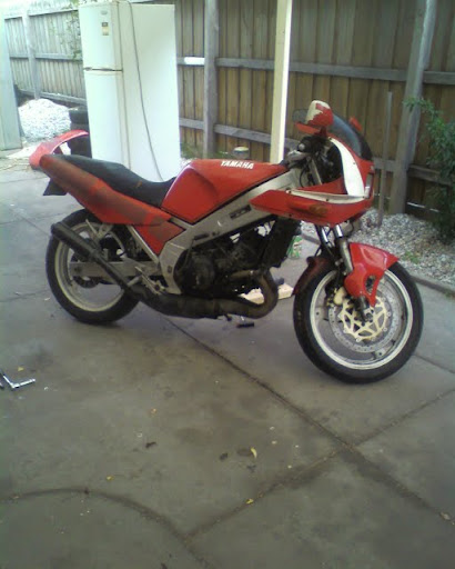

Here is the TZR 250 (with lower faring removed).
Forgot to take a photo befor I started !
With the ICE removed - but lots of oil every where on the lower frame.
After first round of cleaning. Note the bolt on cradle on the ground. This will be replaced with a battery box - no cradle bars in the way.
Stripped back even further and second round of cleaning

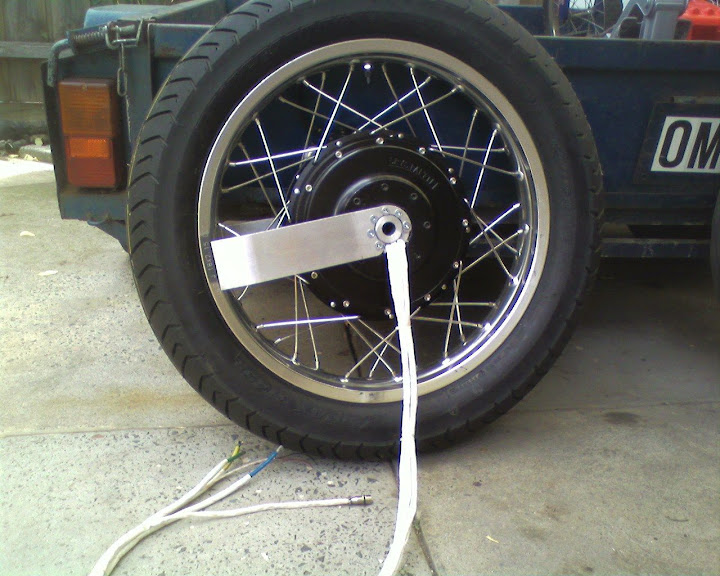

I have sorted out my confusion on batteries and voltage.
Mark from enertrac got his test bike up to 80 MPH on 102 volts (using 3.2 volts for the thunder sky batteries) so my 115 volts should still give me reasonable voltage when the batties are low (2.5 volts X 36 = 90 volts minimum).
By my calcs I will need 80 AH batteries (Thunder sky has no such beast) assumming I can get the wats down to 115 per mile.
Also my wheel/motor arrived today. No import duties either - bonus.
I will have some more pictures soon.
I have to say Mark from enertrac has been realy helpfull and the wheel only took about 2 weeks from placing my order to ariving at my doorstep.

Here is the hub motor with torque arm and intergrated disk brake assembly (and a tyre fitted). The tyre looked to be lower profile when I bought it but on the rim it looks huge. I may have to get another one (dam).
Torque arm on other side (I got the motor with the optional 2 torque arms). The torque arms need to be bent (a little) to fit nicely in the swing arm.
The 2 stainless steel spacers I made on the lathe for the hub motor spacing in the swing arm and also to take up the slack as my axle is slitely smaller than the hole through the motor).
Here are the dodgy looking brackets to hold the torque arms to the swing arm.
Here it is mounted to the swing arm (note that the brackets are to long and hang down belowe the swing arm). I may make (or modify these) to look a little better.
I need to finish reconditioning the swing are linkage bearings and then its onto the battery box.
I was looking around at other motor bike conversions and found a battery box that was relly tall and thin (fitted between the twin spars of the frame) so I am going to pinch this idea and do the same and make it of aluminium plate so it can be the stress member (remeber I am removing the bolt on cradle). To this central battery box I will attach another one each side (3 all up).
I have only done some rough meseurements but with this aproach I might be able to fot 36 X 100 ah batteries. I am in the process of finding out if the extra weight will be legal or not. Thunder sky's are 3.2 kg each so thats 115.2 Kg's or Sky energy's are 3.1 kg so 111.6 kg's. The bike was 151 kg's with the ICE and full tank of fuel. So already its over its original weight (bare frame is 50 Kg's) and this dosn't allow for the battery box and all the other stuff to go on. Possibly 20 - 30 Kg's heavier than before.
Regards
Glenn Marks
