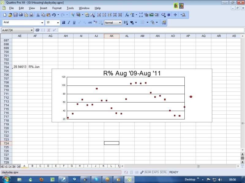

When the Commonwealth introduced their solar rebate scheme, KRudd wanted to have 20% of all power generated renewably. (What I call the R%)
Here's my effort, month by month:
It's pretty hard to get an exact figure, but I think I'm about $200 ahead in my income stream over that period ... I've sold $200 more electricity than I've bought.
Joe
