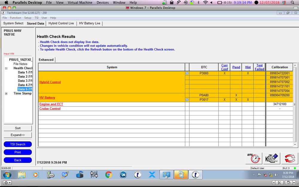

Example:
2007 Prius with 148,000km - one of the modules died a while ago.
These error codes indicate a fault in the hybrid battery, particularly in block 7 (ie P3017 indicates block 7... the battery modules are paired into blocks):
You can see how block 7 has a lower voltage than the other blocks, indicating a faulty module.
For rebuilding/repairing a hybrid battery, refer to this thread on the PriusChat forum: https://priuschat.com/threads/gen-ii-pr ... ent.125588
