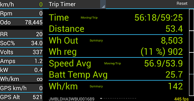

Hello Malm!
Could you please show us a screenshot from Panel Trip Timer from this trip to see Wh Out & Wh reg also?

From 100% to 34%: 8,503 Wh out and 902 Wh reg = 7,601 Wh
142Wh/km - Distance 53,4 km - Wh used 142*53,4 = 7,583 Wh (Ok, that 142 should be 142,34 Wh/km).
So if 66% is 7,6, 100% should be 11,5 KWh. I think this is the number (seen by Canion), my i-MiEV "think" the battery has 11,5 KWh when is full charged. As I showed, It goes from 100% to 0,0%, with something like 3,3V in the weakest cell, so I think is getting the capacity right.

11,5/14,865=0,77. The capacity of my car today is 23% less then yours last year.
