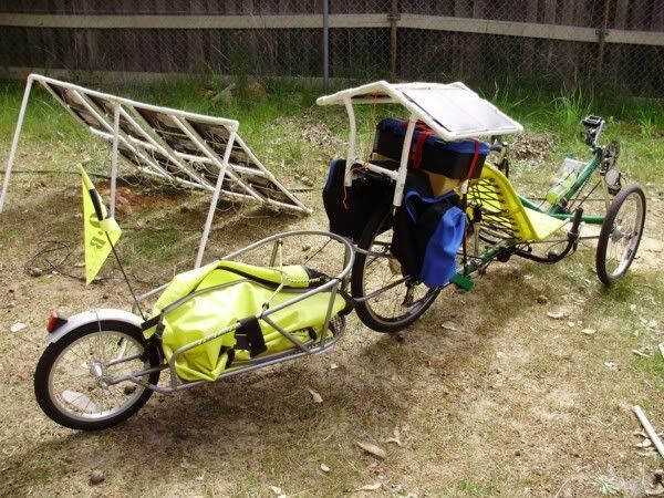

My first portable set up I had the "V" shape to try and minimise width but I soon worked out that even if I flattened them out they were still not as wide as my body, and I was not getting the maximum solar incidence.
This pic shows clearly the batteries in the blue box up behind my head. Not good for handling.
Joe

To give you very rough idea of the area of panel required, each of the small flexible panels on my array is nominally 12 volts (no load) and 2.68 watts. Under load they were rated at about 8 volts. Allowing for losses etc, I reckoned they were putting out about 2 watts each. So imagine 100 of those small panels to theoretically achieve 200 watts.
Joe
There are 16 panels on the free standing array.
