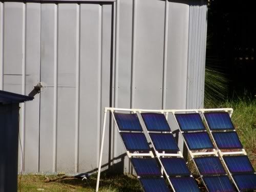

I built a couple of solar-trikes using Heinzemann 24volt 250Watt hub motors, and fitted with photovoltaic panels.
By not using a big motor (and being prepared to pedal a bit) I can use the trailer for carrying things other than batteries. This piccy shows the trailer carrying a fold-up bicycle.
In the 4 years I've had the PVs fitted, neither machine has taken any power from the grid.
The average speed for the red trike is about 18.5 km/h and the green one is about 19 km/h (over about 500 km each), including a very steep gradient about 5 km long on each long ride.

Wow thats very impressive. How powerful are those solar panels?
I'm hoping to score one of those trailers similar to yours, but i'd want to convert it so I could mount it to the back of the seat.

The panels in the photos are my old ones which I've replaced with "concertina" ones:
Nominally, the panels are 20 volts and 20 watts, but in real life, under load I hook two of them up in series, and generate 24 volts. THe ammeter tells me I'm getting about .7 amps, which is about 14-17 watts.
Because I only use the motor for taking off from the lights and climbing hills, if I ride to Perth and back (about 25 km each way) the batteries are usually fully charged by the time I hit the bottom of Welshpool Road. However, if it's a sunny day, I'm able to just use the motor for a km or 2, knowing that the batteries will recharge in time.
Because of the different sized wheels the two trikes have different charactistics. The green one (26") will max at 26 km/h without me pedaling, while the red one will max at about 17 km/h. However, I know from bitter experience that the red trike will get me up Welshpool Road without pedaling. I broke the rear derailleur one day and had to come home from McCallum Park in South Perth with little or no pedaling.
However, it wasn't a total loss ... I met a very nice young lady in the park and we had lunch together.
The trikes are great conversation starters.
Joe

- Groupie
- Posts: 49
- Joined: Mon, 08 Feb 2010, 23:27
- Real Name: Joe Blake
- Location: Lesmurdie
Comparing 36v 250w to 500w Hub Motors
I wonder if a mirror/lense system may work which may allow you to run an Octoganal shape tube with solar panels on the inside? Silly idea I know (not very well thought out). At least there wouldn't be any particular reflection unless you looked at it from the sky.
Whilst it won't be portable in the sense of putting it onto your bike, I initially had a free standing set of PV panels which I used to charge the batteries on the green trike.
To get a bit of extra power from them I experimented with building a reflector made from old CDs/DVDs, cut with a paper guillotine into hexagonal, rather than octagonal shape.
As you can see the hexagon is the most efficient "packing" shape. Just this small reflector could give me between 8 and 10% increase in output from the panels.
After a while I took some of those panels and put them on the back of the trike.
You mentioned that the batteries will recharge in time when using the motor for a few km or 2? Does this mean that for some of the trip you will just ride with the motor and the system will recharge by the time you finish your run? I'm really curious to see just how much solar panel is putting back into your system.
Yes. I try and get the timing so that when I hit the bottom of the hill, the batteries are fully charged, so they won't go flat on the ascent. That's never actually happened on any day, although during summer I've had the thermistor on the green trike cut out because the air temperature is so high that the motor overheats. However, a few minutes to cool down and the motor started up again. (Heinzemanns are good like that from what I've heard.) This trike is much more likely to overheat because of the higher gearing of the bigger wheel.
I can't give you any solid figures on power in vs power out, I'm just happy when the ammeter drops back to zero. This means that the batteries are fully charged and the regulator has tripped.
I wonder how big the panels would have to be to run off purely off solar panel with around 200-250w of power.
I think the answer to that question would depend on so many variables, time of day, time of year, temperature, efficiency of PV panels, how much percentage of throttle is used, weight of the rider etc etc, one could only theorise about it. I suppose arithmetically, you could get a ball park figure by saying if you run the motor at half power ie 100 watts, then assuming the panels in my piccies put out their nominal maximum of 20 watts, then you'd need roughly 5 times the area of panel. That's where the batteries come in handy. If I run the motor at 100 watts for one minute then theoretically my 20 watt panels could replace the power consumed in 5 minutes.
The panels themselves measure 52 cm x 42 cm which is roughly 2100 sq cm, multiplied by 5 gives 10,500 sq cm. (I'm quite expecting to be shot down for my crappy arithmetic.)
However, the jigger factor here is that the Heinzemann motor is geared to a maximum of 193 rpm, before it "cuts out", so even though it may be possible to achieve the theoretical maximum speed, under different conditions of wind, steepness of gradient etc, eg if there's a tail wind the speed may not exceed 193 rpm, there'll be less power used, and so forth.
