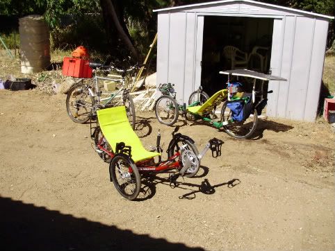

Here's a blog article on my own electric recumbent trike.
http://www.wired.com/autopia/2008/09/solar-trikey-ma/
I've since bought another one, but haven't (as yet) fitted the photovoltaic panels.
Although the motors in each trike are exactly the same (Heinzmann 200/400W), because it's turning a smaller wheel, the red one can almost climb Welshpool Road (for those who know Perth) without pedal assistance.
It can also tow the BoB trailer, so it's great for either local shopping or a trip to Perth and back.

looks pretty gud,
the red one with the yellow seat - thats a greenspeed isn't it?
my dad put 65'000km on his, only just had to get rid of it due to fatigue on the welds at the frame bottom.
the green one - is that a PV on the top?
it looks a bit warped :S
Matt

They're both Greenspeed. The one with the "warped" PV array is a 1992 model (VERY ancient) GTR 20/26. It also had a break in the frame, but I sent it back and that was fixed in about 1993. Still goes like an old trouper.
I don't know how my km I've done, but at least 40,000. (It got stolen, but came back home after 5 years.)
The warp is simply a matter of me being a bit overenthusiastic with the heat gun when I was shaping the PVC struts underneath. The array and its mounting is now into its third year, so it's allowed to be all bitter and twisted. Image
The red one I received in December 2009, so it's still (sort of) shiny.
Joe

Well, here's another update for you then. Image
The new trike has now got not only a "new" set of photovoltaic panels to keep the batteries charged (hard in wintertime without the sun)
but also a (very rough) bikini fairing. I've also added an extra five teeth to my biggest chain ring, so I'm able to travel at a higher top speed (approaching 45 km/h on the flat, un-electrified.)
Joe
