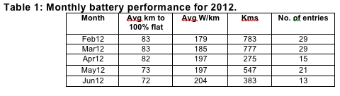

I am worried about my traction pack, and would appreciate some guidance. Please dont tell me its too small for the car... whether this is true or not, that is the fun of a one-off design. We were not a manufacturer who gets development time, so the MR2 became ZEV240 and now Id like to work with what Ive got. And I was hoping for a few thousand recharges, not a six hundred, before having to renew the pack.
In summary it is performing very poorly, after being pretty sprightly in its first two years. Also the range is dropping slightly too. I suspect only a few batteries, but I do not know how to read the data...
Here are some details about the traction pack, and Ill attach in a second post, some voltage tables and graphs as a result of logging the batteries (8 at a time) until all 45 were recorded. Data recorded late May. A word version of this report is available - just ask.
------- Battery Report on ZEV 240's traction pack, June 2012) ----------
Background
My EV is a converted MR2 – rego ZEV240 - a DC conversion now two years old, and still great fun to drive. There seems to be a problem with the traction battery (45 100Ah Lithium batteries c.3.3V ea, total c.150V). Here are the issues and some data from a data-logger (which does 8 batteries at a time) and graphs of the same data – six sets all told.
Issues
Not all batteries are _exactly_ the same, of course; and that is why ZEV240 has a BMS (battery management system), whose major purpose is to get them all up to full charge equally by the end of the charging cycle. The red BMS error light indicates there is an error condition, either constant or flashing under different circumstances. Since about January this year I have seen the light come on during normal driving. Didn’t happen before, that I noticed. Recently the red BMS light appears even if I accelerate only moderately. Watching the gauge, this is at approx. 135V (and 45 x 3 = 135). This suggests that the av. Voltage below 3V/cell is one of its error conditions.
Also since about Jan there is a gradual loss of power and I notice I cannot get away quickly if I need to, eg turning right across traffic, which one has to do occasionally. It may be exacerbated by winter chills, maybe below 5°-10°, but Im sure it started much earlier (ie in Australian summer, Dec-March).
Note that the pack still settles back to about 149V or 151V after overnight charging, so no battery seems to be performing seriously below average at the start. My feeling is that, over the last 3-6 months, the ability to accelerate has dropped significantly, but the 'mileage' has only dropped by a few percent. Table 1 below shows the actual data by month since January. I can imagine that if say 1 battery out of the 45 were very weak, (about 2% of the capacity) then that might account for it, since they all share in the load at times of peak power (and one is very weak, drawing the rest down), but each gives its best as they are all slowly discharged (hence the drop of only a few percent). That’s not exactly how it is, I know, but it leads to the big questions –
1 which battery or batteries, are weak? And the next question is:
2 How did it happen so quickly (within 2 years for batteries with a predicted life of 8+ years) and
3 what can be done?
Table 1. (old link stopped working-fixed)**

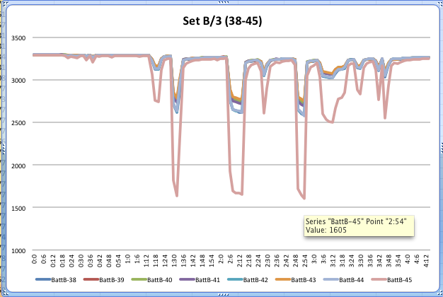

Drove the same course 6 times, moving the data logger each time to a different set of the 6 groups of batteries. Took car on a circuit total time approx 4.30 min from top of driveway and back. Each test pushed the batteries four times, the first 3 times were pedal-to-the-floor acceleration to 60k/h. On the timeline these are about 1:15min, 2min and 2:45min. The fourth – less pressured – was back up the driveway at about 3:45m or 4:00m. Batteries were at ~70% at start, ~40% after the six tests, so not ideal testing. As the whole traction pack voltage drops slightly during use, the later V measures would be slightly lower than the early ones.
The Data
The data logger records the voltage accurate to 3dp roughly every second for each battery. Each test cycle is reproduced here in two forms: firstly a table of data with 8 columns and the time count down the left, but only the middle period c.1:15m to 2:45m or less; secondly a graph of the voltages with voltage up the left scale and full timeline along the bottom from zero to c.4:30m. The eight cells are shown as 8 different coloured lines. The lowest point is usually identified and its value listed, so it can be located in the corresponding data table.
Next post should have all six sets of data tables and graphs etc.

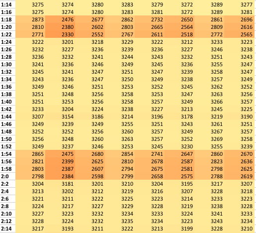

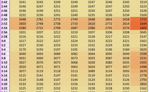

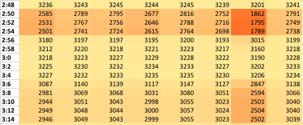

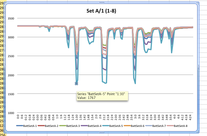

First set A, UNDER the car...Set A: 1-8 (Pack at c.70% at start of test cycle).

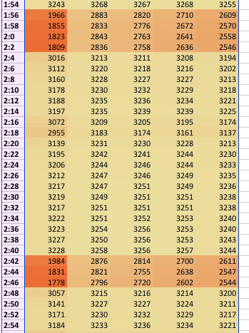

               A1            A2           A3            A4           A5           A6           A7           A8
Getting smarter... the Conditional colouring now has a minimum of 1800 (ie 1.8V) rather than using the min of the 8pack.... And here is the graph of that set.
|| The question is: What can you tell from this graph? Which batteries should I replace, and why!
}} All graphs are similar. Eg, Is it the batteries that go lowest, or those that recover slowest (not the same).

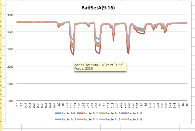

Batts#9-16:

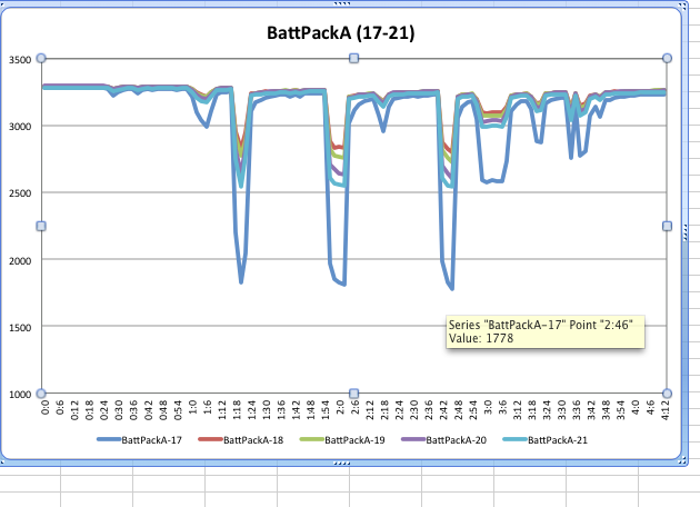

Set A 17-21
        17              18       19          20         21

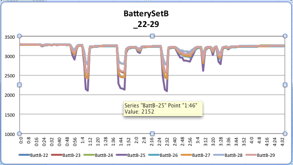

I think Batt #s 22-29. Second set done last as I learned what to do…
(Pack capacity down to c.55% by now)

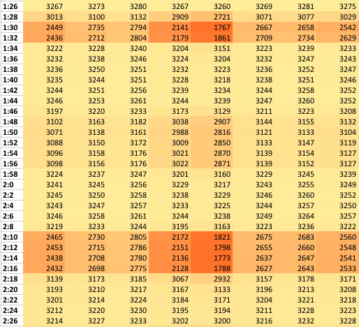

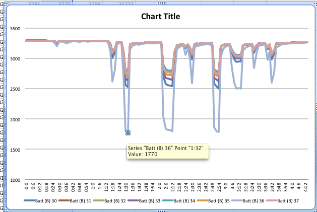

Next: 30-37:
               30            31            32           33           34            35             36            37

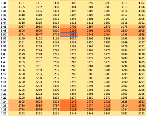

Then finally, 38-45…(Pack dropped to c.40% by this time)
               38            39            40           41            42          43             44            45
Summary:

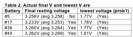

If dropping below 2V and recovering slowly is a measure, then batteries #5, #17, #36, #45 are issues. (Table 2)

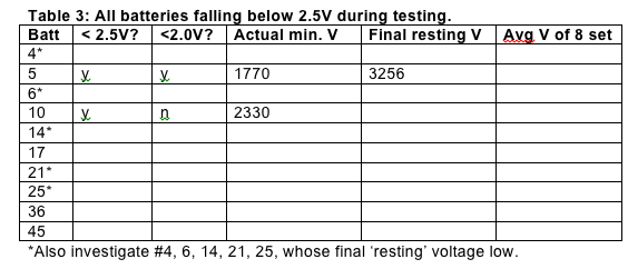

If dropping below 2.5V at any time is a measure, 10 batteries are identified (Table 3):
If final ‘rest’ voltage (ie after a minute or two’s recovery) is a measure, then investigate #4, 6, 14, 21, 25, whose final ‘resting’ voltage low. They dropped much more than all others, lower than many identified as weak in Table 2.
Which of these identifies the truly weak batteries that need to be replaced?
What about pack voltage o/night settling to 149V? or 151v? Is this good? Sure it is, the pack only started at about 152V in the start…And 3.3V x 45 cells ~ 150V. Ok, relax.
The Criteria for judgement
Dont know, of course; that’s why Im sharing this data. But looking at the graphs it seems that some batteries recover within minutes to within 0.01% of the average voltage, while others take a long time to do so. One obvious distinction, as I created and looked at these graphs, led to building Table 2 above… In this case ‘the weakest’ were those that…
a) fall below 2.0V under load, and
b) do not recover to quite the same level as or better than others within minutes (altho this is only millivolts difference, apparently, but it might be significant).
The third table shows all whose voltage fell below 2.5, regardless of their recovery (or the state of the battery pack, which dropped from 70% to 40% during the test process).

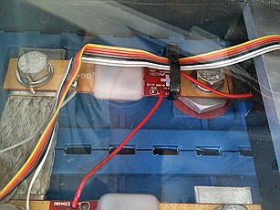

**Is it corrosion? I was shown how to clean all battery contact surfaces before installation, and tried to clean them very thoroughly, using cleaning agent and finally a soft rubber, before we attached the BMS module onto each battery. Perhaps some of these connections have oxidized enough to reduce apparent battery performance of a few?

barney wrote: **Is it corrosion? I was shown how to clean all battery contact surfaces before installation, and tried to clean them very thoroughly, using cleaning agent and finally a soft rubber, before we attached the BMS module onto each battery. Perhaps some of these connections have oxidized enough to reduce apparent battery performance of a few?
I think that's the first thing to check. It could be as simple as some of the cell terminal bolts have come slightly loose with vibration. So you could either just torque up all the connections to the specified torque, or you could run a non-contract thermometer over the connections after a drive, and see if there are any terminals that seem hotter than others. (But they could be hotter because the batteries are high resistance, and therefore getting hotter internally). [ Edit: this could be used to choose one or two terminal connections to take apart and inspect thoroughly for corrosion. Or of course, you could use your data to choose these one or two, then check if the data improves. If it does, clean up at least the ones that the data suggests are a problem. ]

How are your cells clamped together? Can you post photos?

If you think you have a few dud cells, just replace them with new ones. While mixing old with new is not recommended, spending another $10k on a new pack is hardly an option either. In fact, if the newly replaced cells start to cause trouble in another 600 cycles, you have at least got your 1200 cycles albeit costing a couple hundred dollars more than planned.
But definitely go through and check all the terminations and make sure there's no corrosion and that the bolts are torqued down properly. While the pack is small, it's not exactly undersized. Hope you enjoyed the 'Revenge' movie!

- I agree about the possibility of corrosion on battery terminals reducing performance. Terminals should always be cleaned before installation, but corrosion (Al2O3 in particular) reforms over time if you don't have Noalox (or similar) keeping moisture & oxygen out. I know people who have noticed a *big* difference after re-cleaning terminals (and adding Noalox) after even ~6 months. You can Noalox from EV Power, BTW.

ZEV 240's traction pack... feedback round 1:
Thanks to everyone who made suggestions and comments. I'll try and answer them briefly here.
Corrosion was the first thing Coulomb and Zeva commented on, and of course I hope they are right and it is not an underlying battery weakness.... I assume that the batteries with the lowest drops in the log charts are good initial candidates to check, although Coulomb suggested a non-contact thermometer (are these easy to borrow, btw?) to measure all terminal temps after a drive looking for hot connections. At this stage the motor bay pack is easier to get to than the lower petrol bay tank!
One approach suggested to me is to move all the apparently dicky batteries from the lower pack, which is hard work to remove, up to the motor bay pack and then it will be easy to measure test & replace. Sadly this means only older ones are left below yet you'd want the newest ones there to minimise access issues later!
Rather than moving batteries around to do more testing it would be great to be able to identify all the dicky batteries based on the current information alone; and then do the battery swapping AND install the new batteries below, all in one pass.
Next question is the condition of the batteries themselves, addressed by Coulomb, Antiscab, weber, jonescg and zeva. The fact that the BMS battery light comes on whenever I start putting my foot down, is a concern. As Rod Dilkes (BMS designer) said with mastery of the understatement, 'a battery is very weak'. I hope that he too is right, and its only one! I have always faithfully kept the battery DoD to less than 80%, and have records to prove this, as Ive been keeping a monthly spreadsheet since the beginning. Once it got to 19% remaining, otherwise it has always been above this. But the Zilla controller has a maximum amp draw set of around 500A, iirc. It may be lower; Id love to build a serial cable so I could examine the Zilla monster's settings myself, but couldn't find the wiring specs to match to a Psion 5 palmtop I still have lying around. The first thing I should do would be set it to max out at 300 or 400A, I can see.
Antiscab: Continuous draw when on the freeway, where I do max c.90kph - perhaps half of all journeys - seemed to be around 75A to 115A on level parts.. perhaps it averages at about 90A? By my calculations I average about 170W-190W/km between recharges, does this seem reasonable.?
Weber: pic of the battery clamping setup, in this case in the upper pack, now with recently added Junsi Cell-Log wires on each battery is below (to se a larger version, click the link below the pic):
Larger pic
So, I like the suggestion that I replace the bad ones, putting up with the fact that they wont match the existing 100Ah Sky Energy ones. But which exactly ARE the bad ones! Who is ready to suggest which ones should be replaced, and anything else I should do, to maximise the remaining life of the rest of the traction pack?
Barney

I think we can forget loose links and corrosion, now that I see from the photo that you have braided links and everything looks very clean and dry, and when I read your description of careful preparation, and when I look again at the curves you provided.
Although I would still like to know how your cells are clamped together, i.e. in the north south direction relative to the photo. i.e. how are they prevented from swelling.
But I now strongly suspect your charging regime is the problem. I think the cells are just badly out of balance. i.e. those 10 that fall below 2.5 V during your tests are simply at a low state of charge. This would be because they have slightly higher self-discharge than the others and your charging shuts off too soon and never lets them get fully charged, and so over time they have gradually fallen further and further behind the others.
See this post today by Johnny, and its responses.
viewtopic.php?title=johnys-electric-vog ... 707#p38503
What charger do you have? What voltages, what currents, and what algorithm does it use and how is it controlled using BMS information?

You might use your data logger on a set during a charge cycle.

- If you're drawing 500A from 100Ah Sky cells, it is to be expected that they will sag down to below the 2.5V threshold where EV Power BMS modules signal a warning - not that it would be damaging the cells, just the BMS modules are getting confused into thinking the cells are flat. Limiting the Zilla to 300 battery amps (3C) is likely to keep the voltage above 2.5V, but vehicle performance would take quite a hit.
- The braided connectors are tin plated so don't tend to have corrosion problems, but the aluminium terminals on prismatic cells *definitely* do, and even if you cleaned the terminals when first assembled, aluminium oxide tends to re-form over time unless you also added Noalox (or similar) to keep oxygen out. Anyway, looking for hot connections is probably a good way to see if Al2O3 issues are coming into play.
- I've done a bit of research lately into the requirements of balancing from a BMS, and have found that it's actually far lower than most people seem to think. As far as I can discern, cells in series only get out of balance due to differences in self-discharge. Other than internal self-discharge, cells in series always necessarily have the same number of electrons flowing in or out of them.
Self discharge with lithiums is in the order of 1% per month. Differences in self discharge is a fraction of this, amounting to say a few % capacity per year. For a typical EV-sized pack, that amounts to approximately 10mAh per day of imbalance. With a 500mA shunt, that is about 1 minute of balancing time required.
For comparison, many BMS modules themselves will consume over 100mAh per day just for monitoring (~5mA consumption). In fact, for many BMSs, their power consumption (and differences between) exceeds cell self discharge.
So it's certainly still possible that your cells have strayed out of balance, and doing a manual balance before jumping to any other conclusions is a good idea. If you have access to a laboratory power supply, you can use that to bring all cells up to 3.65V individually after doing a bulk charge with your regular charger.
