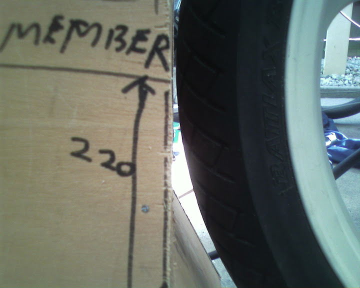

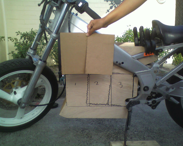

Didn't do too much over easter, Just a ply wood battery box mock up.
Here are some pics (It seems a lot of people are interested to see how I will get 36 X 100 Ah TS or SE LiFePo4 bats. in my frame).
This pic is the central (aluminium stress member) battery box. Two levels of 3 X 3 = 18 (half way there).
The pointy bit on the front at the bottom is just so there is no square leading edge (nothing in it).
The ground clearance is just enough to clear a concreat curb (170mm).
Do I have enough clearance between the layers of batteries ?
Font supension at full compression (no springs in forks). Yes there is clearance - the box could be moved back a few more mm if desperate.
A peek in side the box (3 X 68mm) wide - 204mm.
Forgot to take this one during daylight hours. Another peek inside showing the mount for the steel cradle that I want to cut off.Image
To this central battery box add another on to the outside with Two rows of 3 extending outwards (on the same level) thats another 136mm extra width (battery width is 68mm).
Need to cut the stand mount off. Finding a new place to mount the side stand won't be hard.
Now, a another two above the six like so, and that makes 8 this side.
(With the help of my daughter).
Now 8 this side plus 8 the other side is 16 + 18 = 34 (2 to go).
One can go where the black clamps are (easier to see on previous pic)and the other in front of the back wheel under the seat verticly.
And there we have it 36 X 100 Ah TS or SE (SE are smaller so even easier). It looks like the controller will have to go on top of the battery box. Should give it a nice big heat sink. Originaly I wanted to use this space for storage - I still can but it will be smaller than I wanted now (unless I can find another place for the controller).
Any suggestions gratefully excepted.
With this configuration the battery boxes will be a total of 490mm wide (but that is less than the width measured from the ouside if my legs when on the bike). The foot peggs are even wider.
This mock up will make it easier to show the enginee what I want to do and where I want to alter the frame (cut a couple of bits off). He can show me where he wants the new mounting lugs welded as well.

Post by GRMarks » Tue, 20 Apr 2010, 04:48
Thanks to those of you who answered my question above.
Havn't done much lately.

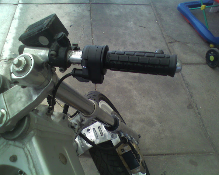

My Controller, small DC-DC converter and throttle have arrived. They arrived last week.
This weekend the enginee came to check over what I am doing. He is happy with my idea of the battery box and mounting point changes. While checking over the bike he noted the compilance plate and found different numbers on it compared to the frame. He said this could be OK as maybe the bike had been in an accident and the frame may have been replaced. He had to check with vic roads for registation history of the frame number. If it had not been registered I would need to get another bike ! I had already given the old sized engine back to the wrecker so I wrang him up first thing this morning (Monday 19/04/10) to get the engine number, as this would help in tracking the bikes reistration history. Turns out that the engine number was the number on the compliance plate (not the frame number). To my relife the bike came up as having been registered via a frame number search so its all systems go now. Boy, am I relieved, I have spent money on this frame already.
He still has a concern over the extera weight the batteries will add - more than 10% of original weight. Hopefully we can sort it out soon.
In the mean time I have changed my plans a little, having recieved the controller.
I am now going to mout it on its side. I will extend the battery box side above the top far enough to mout the controller on it (and act as a heat sink)
Here is some pictures of where I want to mount the controller.
Here is a pic of the throttle
Here is a daylight pic of the mounting point I will be cutting off (inside the battery box) also at the top outside the battery box I will be cutting of the old engine mounts complettly (to get the weight back as far as possible). He is in total favour of this (moving the weight back) and making up new mounts for the battery box.
Once the weight issue is sorted out completley I will know for sure what batteries I can use. Plan "B" is to move 2 batteries from each side to back paniers but this will spoil the look of the bike. Plan "C" is to look at different batteries.
Plan "B" will give 6 batteries behind the battery box and shift weight from the front axle to the back axle.
