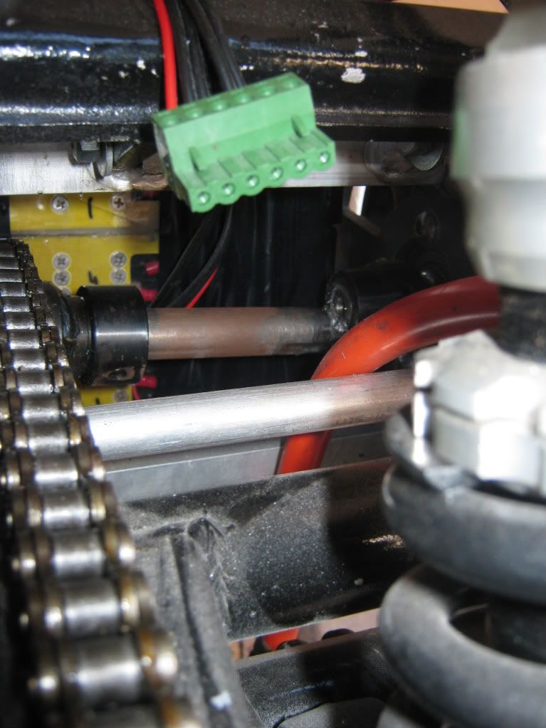

My motor coupling failed recently. The one between the two motors, that is. Thought I'd describe what happened as a warning to other people who might couple two motors together.
I used an old BMW rubber "doughnut" drive shaft coupling modified to do the job and I thought that would be quite satisfacory, bit like a Rotoflex but much cheaper! What actually happened is that the auxiliary drive shaft on the rear motor completely snapped off. This is the shaft out the front and the one that is couple to the other motor's main drive shaft.
The main drive shaft is 1 1/8 inch and the aux one 7/8. but I thought that ought to be able to handle the motor torque OK. There's no warning in the motor specs about limiting the max torque on that shaft.
Anyway, my very clever engineer mate looked at it and decided the two motors were not in good alignment resulting in a flexing of that shaft which caused it to eventually snap off. My rubber coupling which is supposed to take up any flexing had gone as hard as a brick and we think that, with the misalignment, caused the problem.
I bought a new rubber coupling which is infinitely more flexible and we spent a lot of time aligning the motors resulting in shimming the mounting plate of the front motor to get it all in line. By the way, I simply swapped the front motor with an unused aux shaft for the rear one which saved having to do any work on the motors - or indeed replacing the one with the broken shaft.
If you are looking for thin aluminium shim on a Sunday when nothing is open, go to the local shop and buy a can of Coke. Its about .2 mm thick and perfect for the job! You can even drink the Coke, although not recommended.
Anyway, its all back together now and driving as well as before. I might look up a mechanical engineering textbook and see if I can work out what the max torque on a shaft that size can be.
I'd like to add that a new BMW coupling was over $300 and I probably could've bought a Rotoflex for not much more than that!

Hi Neville. Thanks for the cautionary tale. The misalignment and the too-rigid coupling would be enough to explain it, except in that case I'd expect the bearing nearest the break to be shot as well. Did you check it? If it was still good, the smaller shaft diameter may have been a significant contributing factor. Torque capability of a solid shaft is proportional to its diameter squared. So the 7/8" shaft has half the capability of the 1 1/8" shaft.

On the subject of mating two motors, if my Agni motors taught me anything, it's
a) don't do it unless there is no choice
b) if you have no choice, use a very solid coupling with minimal flex and align perfectly, and
c) run your DC motors in series to share the current evenly. If you;re running AC, just use one big motor.

weber wrote: Hi Neville. Thanks for the cautionary tale. The misalignment and the too-rigid coupling would be enough to explain it, except in that case I'd expect the bearing nearest the break to be shot as well. Did you check it? If it was still good, the smaller shaft diameter may have been a significant contributing factor. Torque capability of a solid shaft is proportional to its diameter squared. So the 7/8" shaft has half the capability of the 1 1/8" shaft.
Hi Renard. Thanks for the ZATAOMM story. So true.
The bearing was fine. The shaft actually steps down to the smaller size just outside the bearing. Why on earth they did that, I have no idea. Would've been easier to leave it the same size all through.

Hi Neville,
I think Section 1.6 (pages 21-25) of this document might explain what happened with your shaft. The problem is not the reduced diameter, but the abrupt transition between diameters that concentrated the stress caused by the misalignment and the too-rigid coupling.
http://www.engineersaustralia.org.au/si ... rt%205.pdf
Of course the non-drive-end (NDE) shaft of an induction motor is typically only intended to drive the motor-cooling fan, so this step change of diameter wouldn't normally matter. We are kind of making the same mistake as you. We are using our NDE shaft (which is 25 mm versus the 38 mm of our DE shaft) to drive the aircon compressor, with a permanent side-load due to the pulley and belt. But hopefully this is way less stress than what happened in your case.
The only part I don't agree with is (b). Sure you try for perfect alignment, but perfection belongs only to the realm of the Platonic Forms. Here in the real universe, there are limits to precision, and variations with age, temperature and accellerations ("gee forces").
So what makes you recommend a solid coupling?
In theory you could have a solid coupling if the bodies of the two motors had independent flexible mountings, but I'm guessing their inertia probably means this would be of limited value.
We do have a rigid coupling between two shafts in the MX-5, with independent flexible mounting of the bodies. But this is between our induction motor and its shaft-encoder which only weighs a few grams.

i think i warned you about this when you first posted pics of the motor frame a couple of years ago ?
your aluminium motor mounting frame is not rigid
if you try to connect two motors without a flexible coupling you will break shafts.
end of sermon . nothing more to discuss

Hi HeadsUp. I don't see where you said that exactly, but you made me go back and look at Neville's cradle photos.HeadsUp wrote:i think i warned you about this when you first posted pics of the motor frame a couple of years ago ?
Neville, It's true that for the same thickness, steel is 3 times stiffer than Aluminium. And for the same weight, stiffness is the same but Aluminium costs more and takes up 3 times as much space.
But I think the biggest problem is the asymmetry of the cradle connecting the motor bodies. The way it is, more torque will cause more parallel offset misalignment. It wouldn't matter if the motor bodies were connected with lasagne (high tensile) provided it was arranged symmetrically around the circle so the relative rotation of the two motor bodies was centered on their shafts.
It may also flex causing angular misalignment when you go over bumps.
The solution seems simple. Add a bolt-in "hat" like the one in Zeva's cradle, shown here.

I'd say this would be my main reason:
I had two couplings, one was the drive sprocket, the other was a sleeve. Under a high torque scenario, it just popped out.
So I instead went for a single solid shaft with a drive sprocket at one end:
This one needed the odd brass shim behind the bolts to make the motors spin fairly freely, but nothing came loose or even vibrated unpleasantly. Given the nature of the setup, I can't think where you could possibly mount a flexible shaft coupling.
Granted in Neville's situation, a flexible coupling would work better than in my situation - as all of the torque was being applied to the actual coupling via the chain.

Thanks for a lot of interesting comments guys.
I THOUGHT I had a flexible coupling! I THINK the one I have now is much more flexible than the last one. Certainly it is possible to flex the rubber disk by hand, something not possible with the old one - which came from a wrecker, by the way. I think that if it happens again I will revert to a single motor and go back to a 1000A controller to regain the lost torque. That'll stress everything lots more though.

For those who don't quite see what I had going on with my old coupling. It wasn't a 'flexible coupling' as such. It was a coupling which had flex, when it shouldn't have. The points of flex were the drive sprocket coupling and the sleeve coupling. As I said, it's not really appropriate to compare it to Neville's situation, since the torsional forces due to the chain are strongly radial. The solid shaft joining the two output shafts of the motors was much better.
