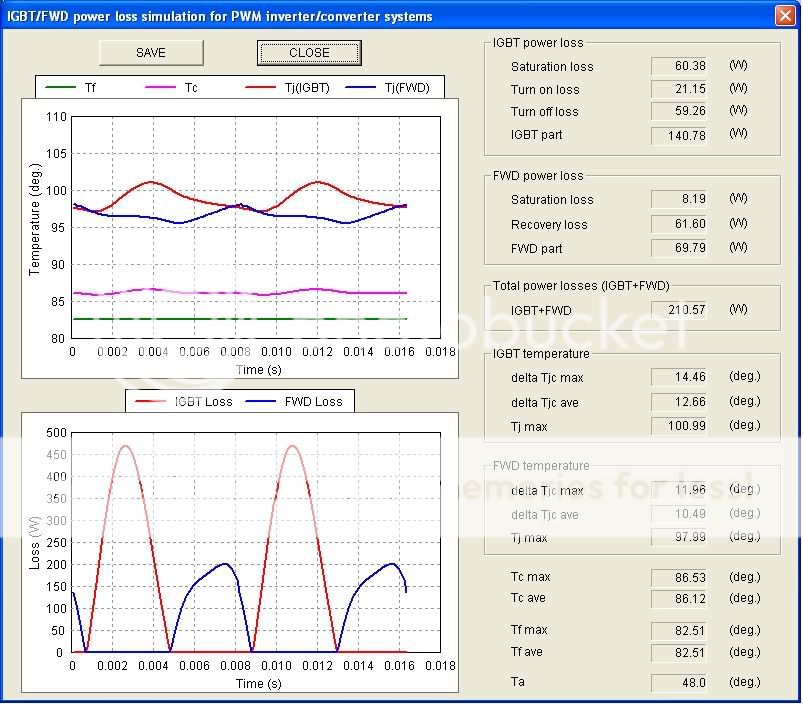

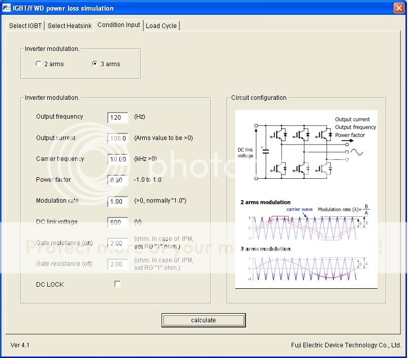

Free application from Fuji for simulating heat loss , efficiency , and heatsink requirements in their IGBT.
you will need to register before downloading it
Free Fuji calculator for heat loss , heat sink , efficiency
sample below as based on 6MB1300U4-120
