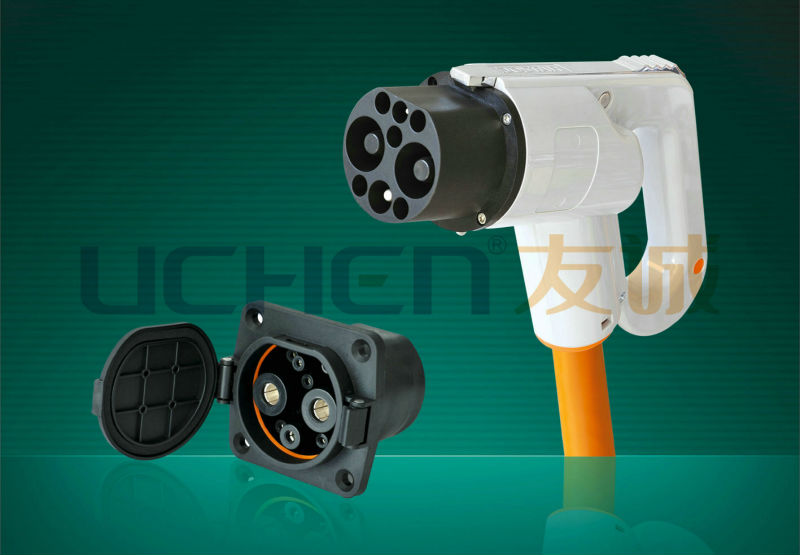

Valerun (with the PFC charger) was getting his from Uchen

That alibaba link says CHAdeMO but the image is not of a CHAdeMO connector??
http://au.alibaba.com/product/807884861 ... -400V.html
compare with iMiEV CHAdeMO connector....
link to CHAdeMO site confirms iMiEV connector
http://www.chademo.com/wp/technology/details/
Is this alibaba unit actually the correct connector ?
iMiEV MY12 110,230km in pure Electric and loving it !

acmotor wrote:Is this alibaba unit actually the correct connector ?
wouldnt suprise me if it wasnt correct here is CHAdeMO DC and J1772 AC, Alternative Sockets as Mounted in the Nissan Leaf
CHAdeMO quick charger connector,125A 400V from Alibaba.com
nope that isnt correct
i carnt find a pic of that plug anywhere other alibaba

That's the Chinese version of Chademo. They've rolled their own copy, used entirely on in-country vehicle and charger sales. It's not compatible with actual Chademo.
I would be thinking that the Chinese have stollen the name and ignored copyright as ususal ?
Charging standard ???? look what menekes-ites have done to de-value 'standard' !
