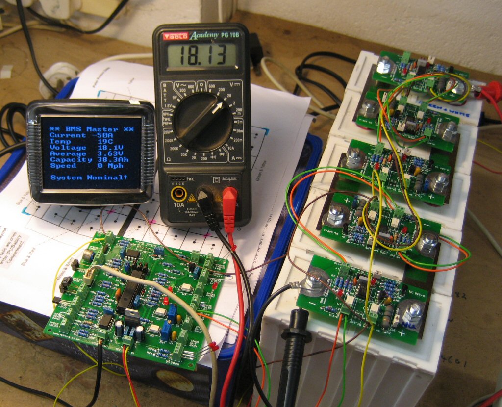

The first bms I designed was a "central" board with 8 inputs - for 8 cells - and used two quad op-amps. The ones I used were rated at 40-odd volts, so could be powered by the 8 cells in series OK. It used the differential inputs and the high CMR allowed it to work very well. The 8 op-amp sections did level shifting and scaling and the outputs fed an AVR micro with 8 A-D inputs, that was the multiplexor. The micro had a UART and did serial comms back to a control unit.
I actually built several of these boards and installed a couple in my car, but decided the long wires running from the cells to the modules were a real pain in the backside and then the new regulations came out which required all of those wires to e fuse protected. At that point I abandoned that configuration and went with the single module per cell scheme that I am now using.
Its difficult to make a central module that could handle more than 8 cells because the voltage goes up alarmingly! The level shifting and scaling needed becomes more and more difficult once you get over 36 volts or so. So if you limit it to 8 cells, then for a 192 cell battery you still need 24 of these modules. I think its more complex and difficult that using single, small and relatively inexpensive cell modules. I think, from memory, that my single cell module design worked out quite a bit cheaper than the 8-cell version. Its certainly far simpler to install and get going.

Nevilleh wrote:It used the differential inputs and the high CMR allowed it to work very well. The 8 op-amp sections did level shifting and scaling and the outputs fed an AVR micro with 8 A-D inputs
Ahh, that makes sense. There's no reason something like that couldn't be done in a similar way that Weber and Coulomb's BMS is layed out (one board spanning several cells), even though theirs is actually distributed. Still the benefits probably aren't there, as you say. Not every pack is going to have an even multiple of 8 cells either.
My BMS is due for a redesign. The cost is right, and the feature set is there, but the implementation needs reworking. I'll get around to it eventually Image

I did part of that circuit today.
It works with normal optocouplers, as long as the transistor is not Saturated the output current is a percentage of the input current driving the IR LED, so this can easily be converter into voltages again with the use of some voltage dividers.
Anyway, no need to reinvent the wheel on this one, I don't see any obvious advantages compared to your circuit.
I have been doing some minor changes on your board for my circuit with headways.
The board is going to be assembled on a panel, so I have redesigned the circuit in a way that both communication ports and power ports for the batteries can be interconnected.
This allows the circuit to be modular, makes things simpler to wire and less prone to noise. I can also use a resistor fuse instead of a wire giving me added safety.
Modified the board to save space.
Removed the Electrolytic capacitor (I am reading a battery so I believe I only need the ceramic one)
Removed two of the SMD resistors
Added holes for normal through hole resistor assembly (For better heat dissipation of the 200Cells)
Added holes for assembly of wires for remote temperature sensor.
This is the first rev, if someone thinks I would be better of changing something please let me know.
I am also looking to implement a battery gauge on it. I have ordered some samples from Texas and maxim. That will be a separate circuit. I will either wire it into the master BMS controller or directly into the car fuel gauge.
Updated Version

Been a while and I didn't see your last post until just now. You are right in that the output current of an optocoupler is proportional to the diode current, but when you see CTR figures like 100 - 300 % you realise that each one has to be calibrated. And then when you find that they drift all over the place when the temperature changes, you begin to understand why the manufacturers go to the trouble of fitting another emitter and use some complicated circuitry to stabilise the things when they advertise them as "linear". But never mind.
Glad to see you have done some work to produce a new pcb layout to fit your Headway cells. Mine was only done for prismatic ones and the whole point of making it freely available was so that people like you could adapt if for their own application. Keep up the good work! By now you may have made some and tried it out?

That sounds like a reasonable scheme - 12 cells per battery box, I mean. Of course, you would need to design the system with that in mind at the start, but that shouldn't be too hard.
The price you quoted was 100-up and they are still $US22 each in less than 25 qty which is what the home builder would be buying. Also, that 4-bit addressing scheme looks a bit complicated to implement with "digital isolators" everywhere and the on-chip balancing fet can't take much current - did I see 20R "on" resistance in the spec? Hence the need for a chip temp sensor.
Its an interesting device all the same, but I like my modular system better - for now anyway.

Another fellow (Arber) who has built my bms is dead set on having top balancing and suggests that turning on shunts for cells that get to, and above, say 3.5V while charging might go some way towards doing this.
My original scheme was to turn on shunts for cells that reach 3.6 V (the max charge volts)and then cut the charger back to 1/2 A so the low ones continue with that low charge rate, but that requires a special charger. If you just have a good old 10 or 15 A thing, then his suggestion might be good. That would cut the charge rate from say 15 A to 14.5A for cells with the shunt ON so they approach Vmax more slowly than the lower cells. The charger would still be cut off totally when a cell gets to Vmax, but that can be done with a 230V relay driven by the charger control signal so you still have an unmodified charger.
A bit of fiddling with the actual voltage where the shunts turn on might make it come into balance really well.
Any opinions?
User avatar
Johny
Senior Member
Posts: 3733
Real Name: John Wright
Location: Melbourne
Low cost BMS
Post by Johny »
I think it would work but you would not get good balance straight away. I think it would take many cycles to gradually get the pack in balance.
Nevilleh
Senior Member
Posts: 773
Joined: Thu, 15 Jan 2009, 18:09
Real Name: Neville Harlick
Location: Tauranga NZ
Low cost BMS
Post by Nevilleh »
Yes, of course, but if the battery was nearly balanced to start off with, the balancing would be done as the charge is completed rather than as an extra thing to do after. Its a simple s/w mod, I think I'll try it out. Watch this space!

I modified my bms to do top balancing and I've been running it a few times to see what happens. I've set the shunts to come on at 3.4 V and the charger to shut off at 3.6 V and I've cycled it four times now. Interesting that the charger reports that it has delivered about 1.6 AHrs each time and I'm now finding that 6 cells are going into shunting - that leaves 39 that aren't! When the charger shuts off, the lowest cell is still at 3.36 V, so there is a way to go yet before they are balanced. Not surprising as they have been bottom balanced all along.
I can't cut the charger back below 10 A so I tried turning on all the dc loads so the inverter sucks a fair bit - the idea being that reduces the charge current while the shunts still bypass 1/2 amp so the balancing should happen more quickly ie the % difference is bigger. Seems to be working.
Nevilleh
Senior Member
Posts: 773
Low cost BMS
Post by Nevilleh »
The bms outputs cell voltage data and I have started to collect and analyse it with an interesting result: Cell 9 has a higher internal resistance than the others, giving a greater voltage drop under load. I have not, as yet, checked the terminals or links - could be a slightly high resistance connection - but it does show a potential problem.
Well, I was going to upload a .jpg of the graphs, but the system said it failed the security scan! "May contain malicious code". So you don't get to see it. I didn't know .jpg files could contain executable code.
Anyway, the curves show all (45) of the cell voltages over a short drive and 44 of the cells are all within a band of 25 mV and track each other nicely. Cell 9 is within that band except when under higher load ie accelerating with a 500 A current draw - when it drops around 100 mV below the others.
