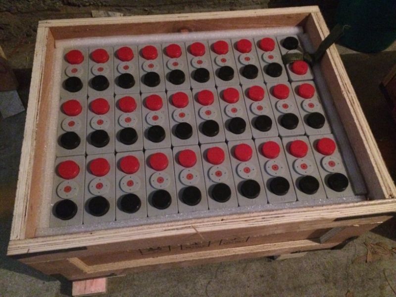

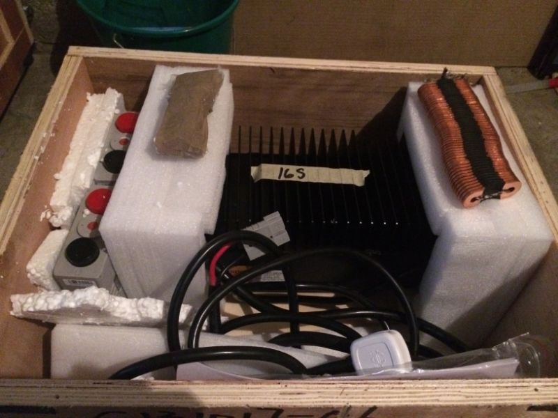

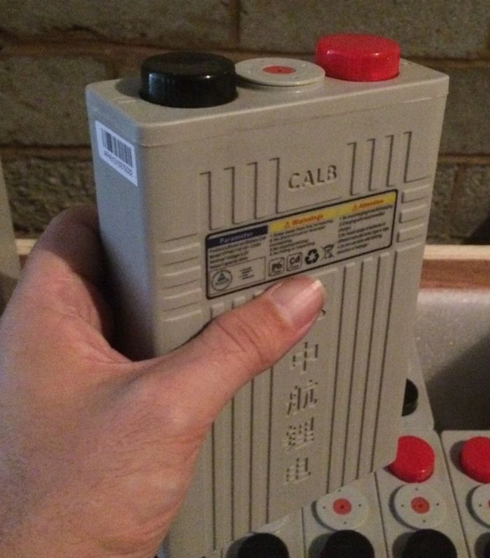

thought i would post a little update....
look what arrived today from EV power in WA :)
32x CALB 40Ah cells, 50x interconnects, bolts and a TCCH 25A charger.
Rod said he will ship the BMS and cell modules in a few days via express post.
Jason.

What are you going to do with charging now a 25Amp plug ? or go to J1772 ? or can you scale that charger back to 10-15amps ?
85turbo
Groupie
Posts: 105
Joined: Fri, 27 Feb 2009, 10:01
Real Name: jason munro
Location: sydney
G2 Prius Plug in Purchased....
Post by 85turbo » Mon, 30 Dec 2013, 14:36
Apparently, looking at the spec sheet for the charger, it only pulls 6-7A when running off 240v,
So I should be able to run it from a std wall socket fine.
It would be beyond my skill set to go j1772, and probably overkill for this project.
Jason.
Jason.
Hi Jason,
I think the "25" in the model number represents 2.5kW power rating.
Eric

coulomb wrote: 85turbo, were the existing cells damaged? Or was it just less hassle to buy new?
Yeah, then existing pouch type cells were damaged by a long period of self discharge.
Now I have one of the 8S groups that has swelled up. So I'm not using the kit at the moment at all.
Jason.
